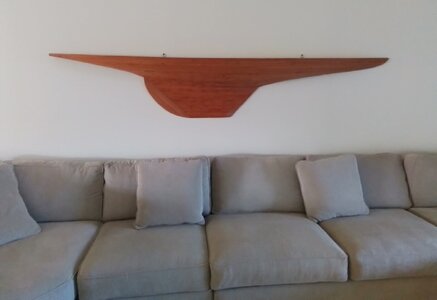

Here is a model I did lately. It's a 1:24 scale half-hull of the 1928 yacht Cambria. The hull alone is made in Rhino. Then you can see the internal parts added, and, finally, there is a screen-shot of part of the laser-cutting layout. It sure would be fun if I could do this whole thing in Rhino, but I doubt it.
And I added a picture of the laser-cut parts.
Finally, this is the second model I have done for this client. Although I don't have a picture of Cambria completed, I did include a picture of the 1:16 scale Reliance half hull I did for him previously.
