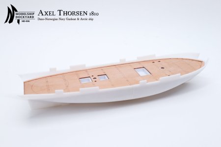

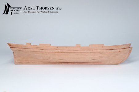

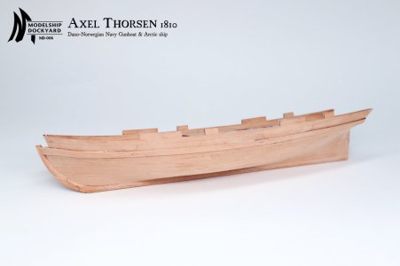

Moving on to the front gunport, first I made the sides of the gunport, the bottom and the back needs to be sanded to a angle so that these two parts can fit in parallel and the back have a slope that fits the run of the wales.

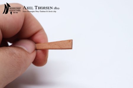

42.jpgThen the upper sill and the parts on the sides. Here there was a error made on the production file, the two parts on the sides should be 2mm instead of 4mm that they currently are, so please reshape them to 2mm if the thicknees is not correct on the kit that you have.

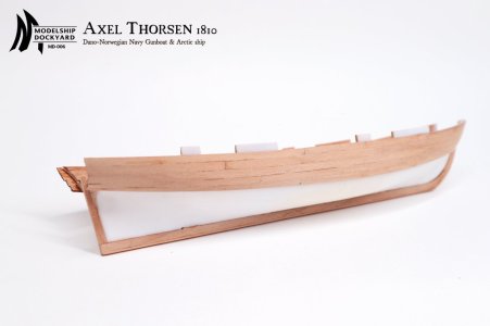

Then we have the basic hull ready. I have added a line on the wale, because they were too thin I have chosen not to mold them. It's totally optional but I think it looks nice with it. The lines will be added on later versions of the kit.45.jpg

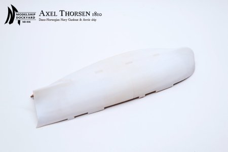

For this build, I have decided to make it the same fasion as the museum build, so that the hull is fully black, so I prepared to paint it. This decision (of paiting it now) was later proven to be not very wise, but we will talk about that later on.

Preparing for the paiting

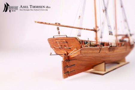

And the rudder, which should also be added earlier. I accedentally placed the rudder hinges a bit high on the hull, so I have to add a part at the bottom of the rudder.
The hull after being paint again. I also added some parts to prepare for the cannons.

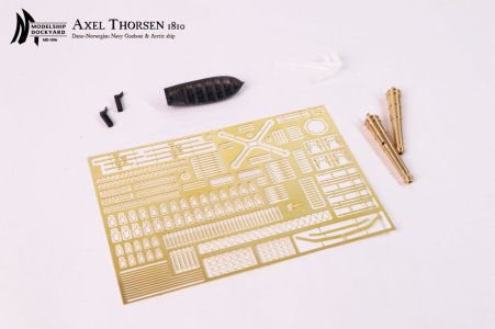

Adding PE parts for the oars.
