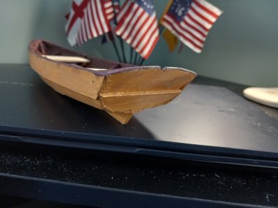

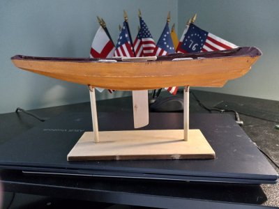

Back to the Norwegian Pram.

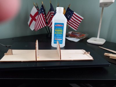

The super glue holds on the wood if you drip a little where the piece you are gluing will go...let it seal the wood and dry, then use the super glue, it works that way.
It holds the brass well then. Wood to wood not so well.

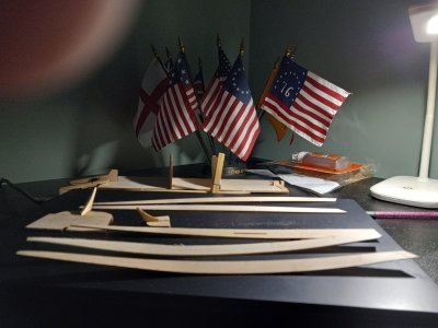

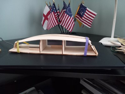

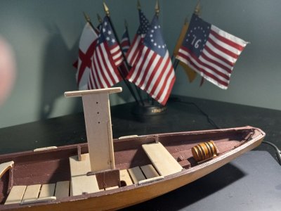

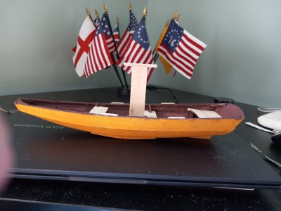

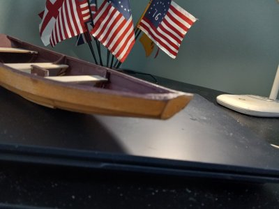

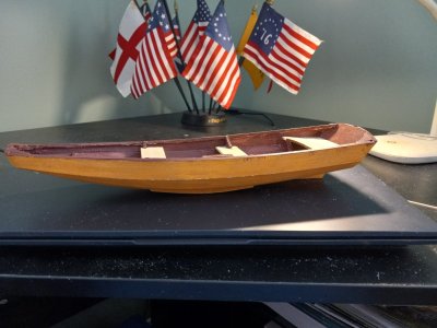

Waiting for parts for the Pram so started the lobster smack
nothing glued, just trial fitting.
