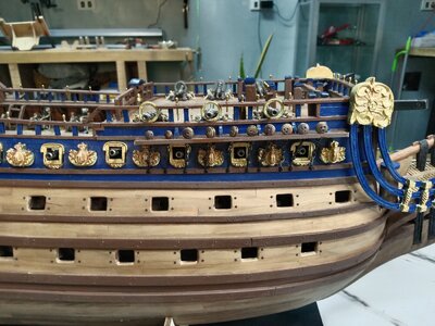

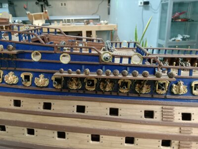

I took a picture of the small deadeyes connected to the chain plate on my foremast and mainmast shrouds I believe they are stays do I rig them as pairs as I do the ratlines and the odd one rig from side to side. I wouldn't bother you with this, but I have looked many places and have not found any article that explains what to do with the I guess jack stays?

My question concerns those small deadeyes that are attached to the chainplates on the main and foremast, I believe they are stays? my question is how to rig them are they rigged as the ratlines are rigged in pairs and do you attach the odd number deadeye as in the 9th from the deadeye to the mast and down to the other deadeye on the other side or is each one rigged singly, I have attached some pictures to help??

I don't fully understand the question about the dead eyes but I can tell you that each dead eye is rigged to each back stay so that each back stay can be adjusted individually. There needs to be two dead eyes on each back stay, the bottom one like you have and a top one a couple scale feet above the bottom one.. The top dead eye is tied to the back stay permenantly. Then a length of rope is attached to the bottom dead eye, run up through a hole in the top dead eye and back down to a hole in the bottom dead eye, then back up and back down until all six holes have the rope running through them. The rope should end up coming out at the top and then it can be pulled down by a sailor of weight to tighten or loosen that back stay as needed. The end of the rope is secured by tying it around itself under the last dead eye that it goes through. How's that for organized confusion? Back stays are tied to the masts individually so that if one breaks it's opposite back stay will still be working. Also it's easier to repair under way when only one line has to be reckoned with and not two. I have a book that explains a lot of this in general terms if I can find it but this is a normal way of rigging the back stays unless the Captain wants them rigged a different way. Right or wrong the Captain is always right. You have a beautiful ship model there bandido. I love the colors. Norgale

The dead eyes are not stays. The ropes coming down from the mast are called stays or in this case back stays. Stays are thick ropes and dead eyes are dead eyes. The stays that are used for rat lines for the sailors to climb are also backstays and are attached as described above. There are usually five or six of them depending on which mast.. Then come the back- stays and their numbers are determined by the height of the masts. Going from the ratlines aft to the next backstay you have the top mast backstay then the top gallant back stay, the royal back stay and then the skysail backstay if there is a skysail. Each one including the rat lines has it's own set of dead eyes. You should not have any back stays running directly in front of a cannon unless the cannon sticks out beyond the back stays.. Norgale
