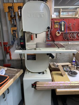

For those of you that use a bandsaw to cut frames and such, what size blade have you found to be the most usable? 1/8”, 1/4” something else? I have a 14” bandsaw that I use for woodworking and resawing with 1/2” and 3/4” blades but would like to use it for modeling as well. I did do several searches for this topic but was unsuccessful in finding any info.

i believe I will order both a 1/4” and an 1/8” from Timberwolf. I do have ceramic cool block guides and I’m looking at the Carter bearing guides but they are $$$!

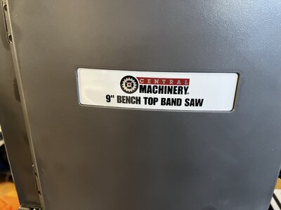

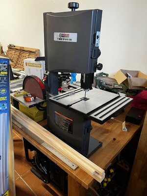

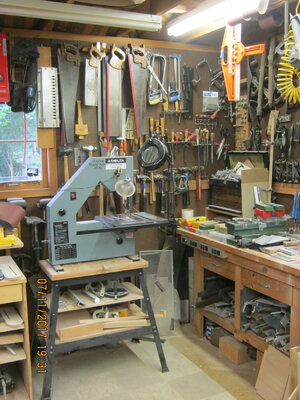

I use a 1/8" fine tooth blade on a cheap, 9" two wheeled desktop bandsaw for modeling since it only has to cut wood less than 1", rip thin planks from veneers, and cut small parts. If I need to cut large timbers, I use the old 1940's 10" Delta 890 bandsaw with the 1/4" or 1/2" blade out in the shop. Whatever works for you is what you use.

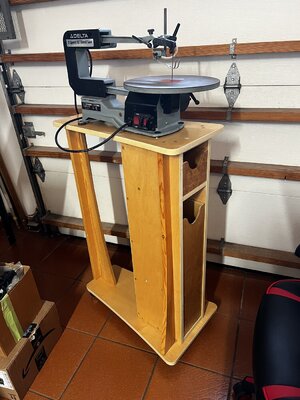

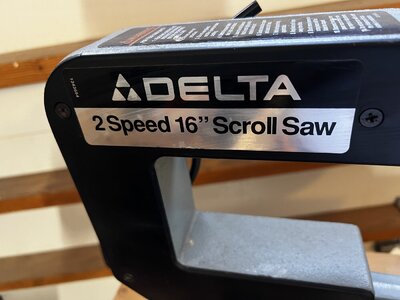

This is my other little work horse that I have been using for over 23 years. Believe it or not, you still can find replacement parts for it.
I made that rolling stand so I could use it anywhere in the garage.
