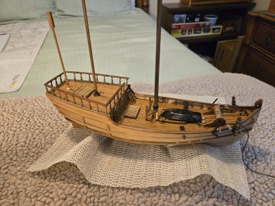

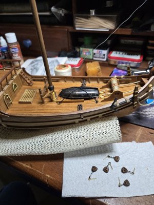

Here's my ship thus far:

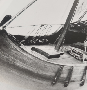

This is an inboard photo of a model.

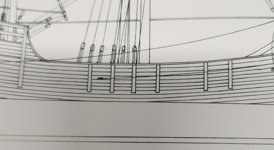

Here is a drawing from the book. Unfortunately the author does not show an inboard drawing.
The author is basing his work on knowledge of the practices of the time, so it is probably reasonable .

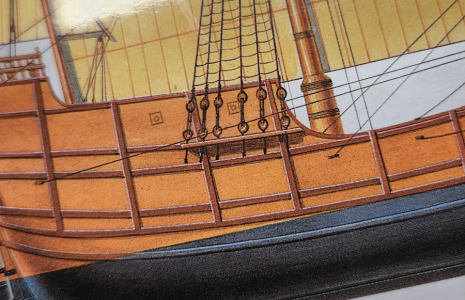

The author shows this on the Santa Maria.
With no clear instructions or parts to follow the drawings above, I think I would just go for something like the Santa Maria drawing.
