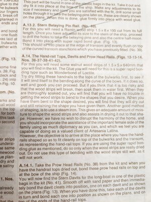

Hello all. I'm working on the Latina Harvey/1840 and have run into a snag that I hope you can help with. I'm at the point of installing the hand rails (walnut) and have to bend them to accommodate the prow shape. Latina even has a humorous account of how to do this (see photo), which lead me to believe that it was going to be tricky, and it is. I have tried soaking the walnut strips in water for two days, and tried an (old) steam iron, and they will not bend. I then thought that a guitar maker would have the facilities to bend the wood and found a lutier in town. His response is "you cannot bend wood in that direction - good luck!" My next step is to mill my own hand rails using a flat piece of wood, but thought I would see if anyone has come up with a solution.
