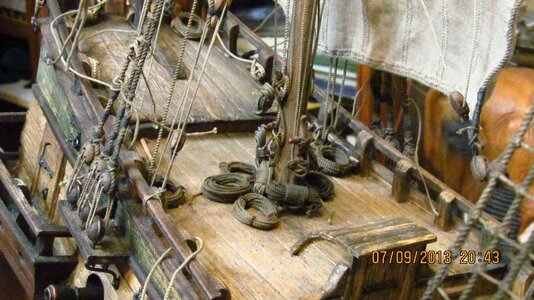

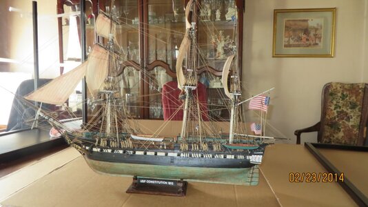

I have been frustrated by my mistakes, but it never deterred me. As they say, "A doctor buries his mistakes, but an architect puts a plant in front of his". When I have made mistakes - e.g. rough-edged planking, tears in the plastic hull, messy wood connections, etc. I always say to myself, "Hey, this boat was in hard service and the sloppy repairs are just part of the history of the boat. I then am able to sleep at night!

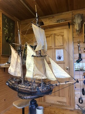

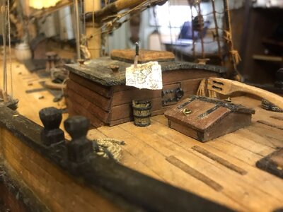

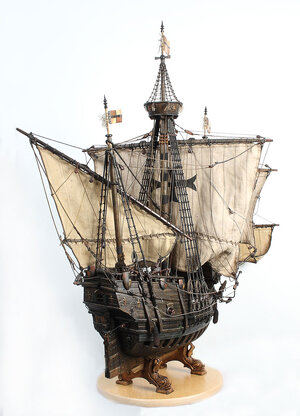

It seems to me that if the model is built in a clean, academic style, then it is better to avoid dirt, scratches and other damage of this kind. There is a different style in modeling - when the model looks old, beaten, “traversed the seas,” “tired of life.”:-) The famous master Vladislav Zhdan builds his models in this style.
It seems to me that if the model is built in a clean, academic style, then it is better to avoid dirt, scratches and other damage of this kind. There is a different style in modeling - when the model looks old, beaten, “traversed the seas,” “tired of life.”:) The famous master Vladislav Zhdan builds his models in this style.
My models always seem to achieve that beaten, weathered appearance through lack of skill and experience in wood finishing and simple sloppy painting and workmanship! :rolleyes:
