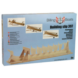

I am prepping for a new build of the Billing Boats Esmeralda. Now in the instructions they recommend you use their Build Slip #397. Now I just so happened to have one tucked away, still in the box. Have had the thing for some time. Any how, into the closet digging to find what I know I have, but is it? I know I am not the only one! So after pulling everything under the sun out, there it was just where I last saw it. I remember opening the box when I ordered and after a brief look, closed the box up and stashed. So again the box is opened and as I set there looking at the directions, I think too myself...simple....yea right. The slip is 36 3/4's long and 6" wide. Looks deceivably simple in construction, yea right again! You get 2 large MDF base parts that you glue together with two small ply pieces, what in the cabinet business refers to as doughnuts. So, this is to build your prized next project that you want everything straight, level and plumb. So, to insure I would get a absolute flat build board from 2 pieces, was assembled on a piece of 1/4" thick plate glass. Googled for best glue f/MDF....good ole Titebond. Then onto the assembly of the components. Again everything sanded and assembled w/squares and weights. Now we are into the second day of building. One thing to note here, you add a center spine in 2 pieces that absolutely has to be dead center. Then on the top of this a wood channel is added, again 2 pieces. So let me go back and eat those famous words deceivably simple....not. The instructions have you assemble the main board and then add the spine. Here is a tip. Before you do this, assemble the moveable head keel support 1st and add the spine off of this. If you get the spine off by a 1/8th, you can not attach the side parts that slide the upper keel keeper up and down the board. Err slight modification on my part. I have built several keel keepers/slips. I have one I have used for the last few years, but this one was the toughest to build so far. But once done, impressive in the design and function of the slip. We will see how good it works soon enough.

Are the two base parts done that way for shipping and boxing reasons? It seems it would be better if it were all one piece, or maybe laminated to another sheet that was one piece. Or maybe not.

They are provided as two parts because of box size. If one lays the pieces flat, ie: on a plate of glass and then inserts the ply pieces that connect. The parts stay flat for now. I have considered screwing this to another piece of board. If I were to build again, I would purchase a shelving board and just build the parts onto it. But seems to be nice and flat and I have already attached the spines and using to build. To be honest, I used because the kit recommended, dah, another item to purchase from them. One could just as easily build their own. One of the things that I do not like is the 2nd spine is a wood channel that the keel sets in. It is wide and you have to shim to hold the keel tight. Would I recommend, well that is still to be seen and I might still might have to go another route and not use if it does not look to keep everything nice and straight. I believe the current price for this slip is $77.00 plus ship. So one could very easily purchase the material from Home Depot to build their self for a lot cheaper.

Interesting review Rick.I remember when the slip first came out.It was much cheaper than it is now and back then it would have cost nearly as much to build your own from scratch.It is annoying that it does hold the keel snug.Billings kits use the same thickness ply for all their models so you thought they would have made it the correct width.

Let me say this, if you are considering buying one of these, don't! It has been a major pain to make this thing work. But with some good ole country boy engineering, I got the keel in it straight and secured. The channel for the base of the keel is 2 times the width it needs to be. The stern and bow supports are too wide as well. Now they give you two pieces of strip wood to use as shims.....what a waste of wood. They are too narrow to be of any use. I purchased some strip wood from Hobby Lobby and using this as shim material, I got it all in. I am sure someone for sure has used this as designed to build with, but for the life of me, I do not understand why they designed it with overly cut slots/channel when as NMBROOK pointed out, Billing Boats use the same thickness for their keels/ply? The concept is sound, but the material as provided for the job is sorely inadequate. I never like being negative about what we as builders have available from mfg's, but this is only for someone who already has a good understanding of what a keel keeper is designed to do.
