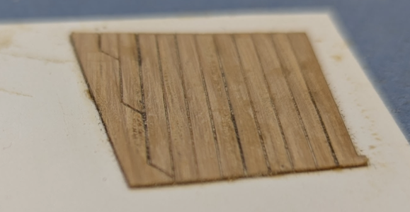

I've glued 0.4mm veneer to plastic and tested various glues. To cut to the chase, CA not so good. Super 'Phatic is much better. The photo shows a test piece using some scrap on a bit of evergreen. As you can see, dead flat and that sample has been on there for a fair while now. What I like about Super 'Phatic is that it is quite watery and you have loads of time to position the parts. The downside(-ish) is that clamping is necessary for those very reasons, as it does not really 'grab'. It remains possible to remove the deck down the line as the glue doesn't 'weld' to the plastic, but you need to use some force so I see this as a plus point.

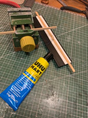

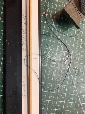

Because of my couriosity i tested Uhu Hart for glueing plastic with wood or vice versa and tested the bonding power after 3 min bonding time using a proxxon machine vice (weight 750 gr) with the help of my dear wife.The result shown in tje attachments seem in my opinion to be satisfactory
