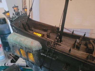

I glued some small dekos to the captain Cabin and I consider the painting mostly done for the right side of the ship. I used color pigments, and fixative spray.

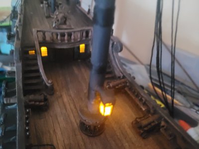

I made some progress in the last weeks. I did not made such detailed photos and instructions as I wanted, I had not much time, I progressed always in small steps, every day a small part. This is the actual state for now. The biggest challange was the electrical connection for the rear decorative lamps.

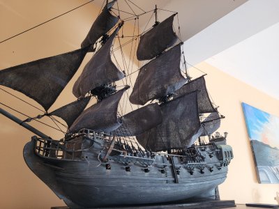

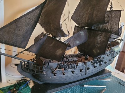

Good day Builders! I haven't posted for awhile. I have managed to build the Black pearl and I'am pretty much happy with the result. I Attached some Pictures from the Black Pearl. Building the ZHL Kit was a very positive experience.
