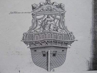

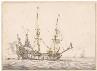

However, my intention is not to build her strictly as the “Black Swan” from the box, and not even to make an exact Black Pearl replica. I would like to use the kit as the base for my own custom pirate ship: something personal, more detailed, more plausible, and inspired by the general atmosphere of late 17th- and early 18th-century pirate/privateer vessels.
In true pirate fashion, I am not against “borrowing” inspiration from different sources: historical ships, East Indiaman / VOC-style armed merchantmen, the Black Pearl, the Walrus from Black Sails, and other fantasy or cinematic references. But the final model should feel like my own ship, not a direct copy of an existing one.
My preferred historical atmosphere would be roughly between 1680 and 1715, within the classic Golden Age of Piracy. I know the OcCre Black Swan is a fantasy pirate kit rather than a strict historical reconstruction, but visually it seems to have something of an armed merchantman or galleon-inspired vessel, possibly close to the kind of ship that could have been captured, modified, and “piratized.”
