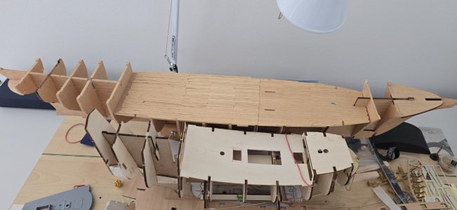

Hello ladies and gentlemen,
would like to write a build report on the Black Swan. The kit is from OcCre, is called Black Swan, and is relatively new on the market. It is in 1:75 scale.It has a medium difficulty level and is supposedly ideal for beginners. It has already been presented here in the forum by Jim. I can, of course, do it again if you wish.I will be completely converting the Black Swan into a Royal Navy ship. She will be a proud ship of His Majesty and will strike fear into the hearts of pirates in the Caribbean.Since I will be converting the Black Swan, she will, of course, also be given a different name.
The name of the future ship is Athena!
The Athena is a fantasy ship that bears similarities to the Black Pearl, the Black Swan, the Flying Dutchman, and other vessels. There is no historical evidence for this ship. The design of this ship is not historically documented, but the shipbuilding influences of 17th and 18th-century sailing ships were taken into account during construction. The Athena's construction resembles a galleon.
The ship's design will therefore be modified to be more similar to historical ships of the 17th to early 18th centuries. As mentioned above, my intention is not to build a pirate ship, but rather to design an aesthetically pleasing and majestic Royal Navy ship.
I apologize for any difficulties I encounter as a novice in wooden shipbuilding. Therefore, I ask for your patience and support with this project.

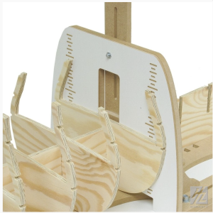

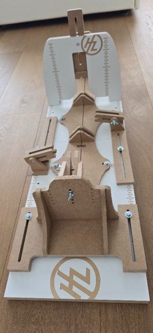

Hey Sailors,

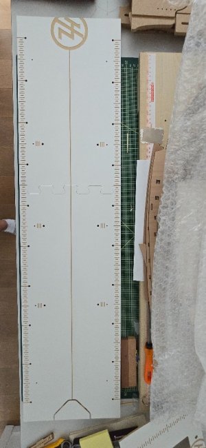

and here we go again with the Athena. I've finally got my slipway. The first impression looks positive. I have to assemble it and then I can write about whether the investment was worthwhile or not. What is immediately noticeable is the good workmanship.
Here are a few pictures. :D

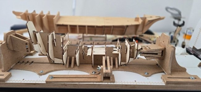

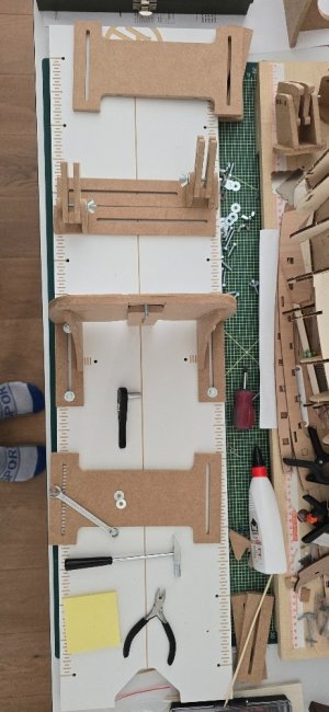

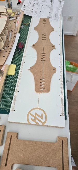

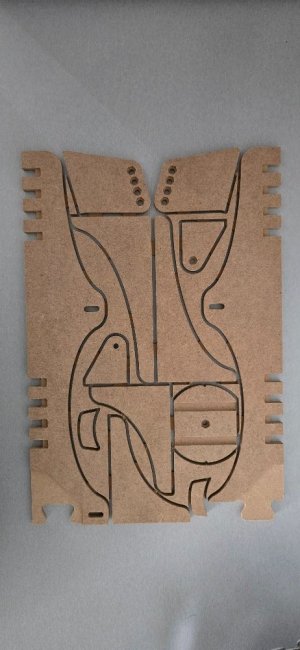

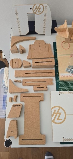

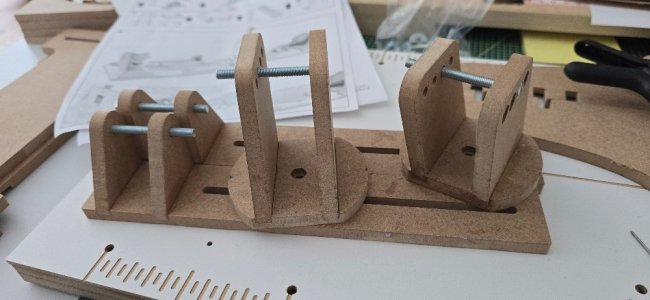

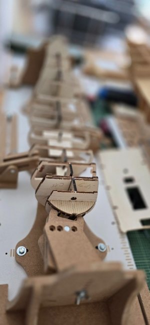

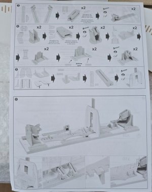

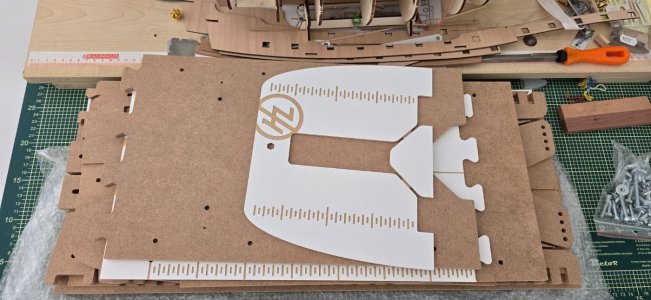

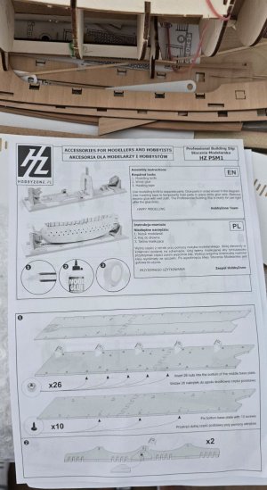

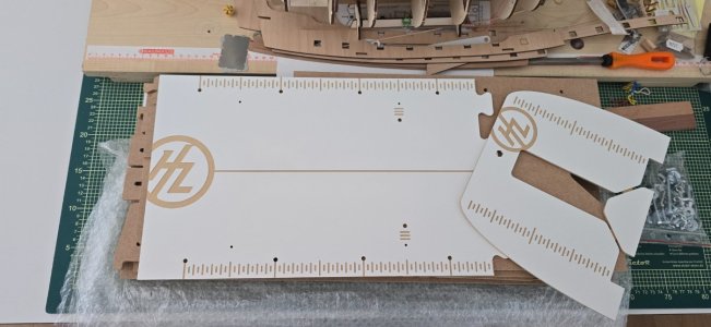

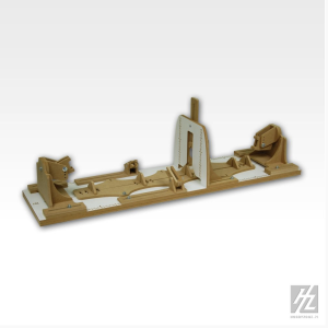

Hey folks,

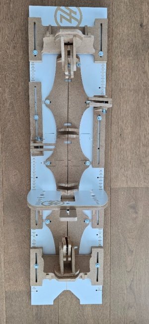

I was really looking forward to the slipway from HZ. Here is my first status report.
It should be easy to build models in scales 1 : 100 to 1 : 72 with the HZ slipway. For the larger scales, I would say that it is not sufficient. You could perhaps build a small boat on a larger scale, but I can't judge that. I'm aiming the slipway at modellers who, like me, tend to build at a smaller scale.
The slipway has the ability to rotate a fixed hull through 360°. Of course, the slipway can be used for everything from laying the keel/false keel to erecting the frames/bulkheads, and it can be used simply to hold and rotate a semi-assembled hull while the hull can be planked and fitted in advanced stages of assembly.
The finished unit has the following dimensions:
A length of 100 cm, a width of 25 cm. It can accommodate a keel up to 7 mm thick. It has a measuring height of 22 cm.

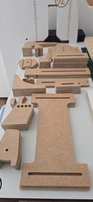

Quality of the slipway.

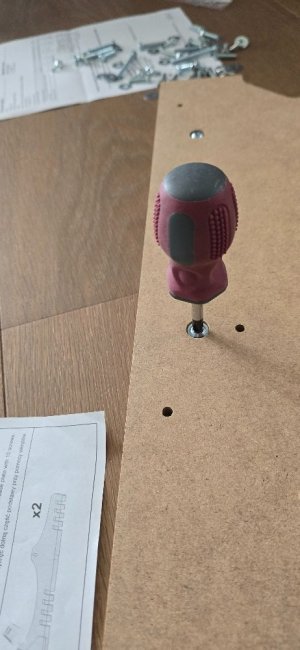

The slipway is made of MDF boards and is a decent 0.8 cm thick, making it very stable and of high quality. All screws and even wing nuts are included in the package.
Not included are:
Cutting knife, scalpel, wood glue, superglue, ruler, clamps.
Quality:
The quality of the slipway is very good. It looks stable and neatly finished.

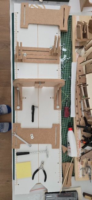

Assembly/instructions:

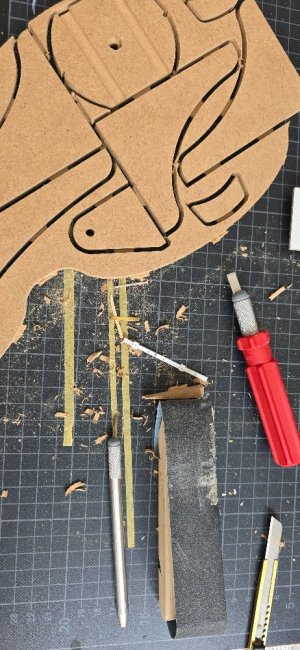

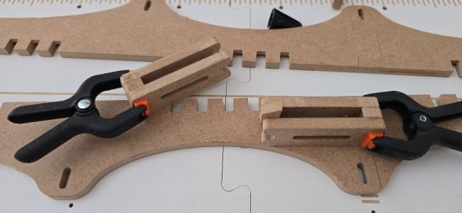

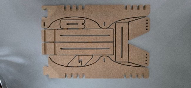

Removing the laser-cut MDF tabs was more difficult than I had expected. I had to use the scalpel on the tabs several times and cut them so that they would come loose. That took time and was no fun. I had to sand down all the detached parts after cutting them out to make them look clean and nice. This also took time. The instructions are written in black and white and are very small for my liking. What annoyed me was perhaps that I am also a bit too old, too stupid: the sequence of the building sections and the pictures, which are so unclear. Sometimes I wasn't sure how to put the parts together correctly. So I had to get through it!
Conclusion:
The HZ slipway costs €72.43 without shipping costs. In dollars it is around $85.00 without shipping costs.
The quality is very good and the screws supplied also make a good impression.
I personally did not find the assembly with instructions so good, but possible. I wish there were instructions in colour and that they were larger, or that there was a good video. Unfortunately, I can't yet share my experience with the slipway as I still have to try it out. But I will report on it.
I hope you can understand what I have written. My English still needs to improve. So please accept my apologies. ;)
Here are a few more pictures for you.
Cheers, Günther!Ship-1

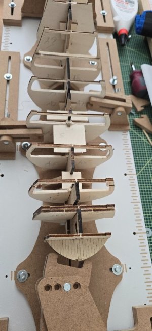

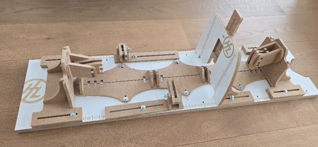

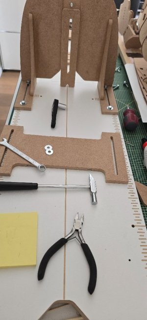

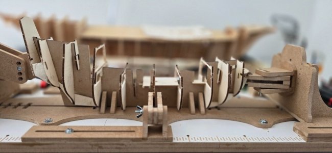

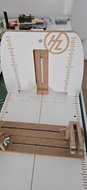

Hey folks,
So, now I've finished the slipway and I'm looking forward to working with it.
Of course, the Athena now also has her dry dock and is waiting for my master shipbuilder to finally start work. Mr McRoudy has already scolded me quite a lot about why I'm dawdling around and why I don't want to tackle the pirate threat as quickly as possible.
I've promised him that I'll get on with it now ...
Best regards
Günther Ship-1
If you have any questions about HZ's slipway, feel free to ask.

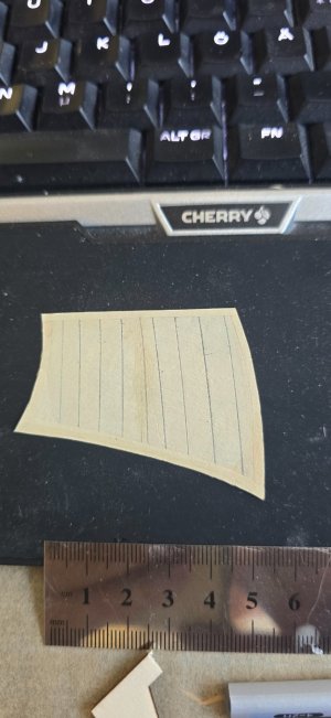

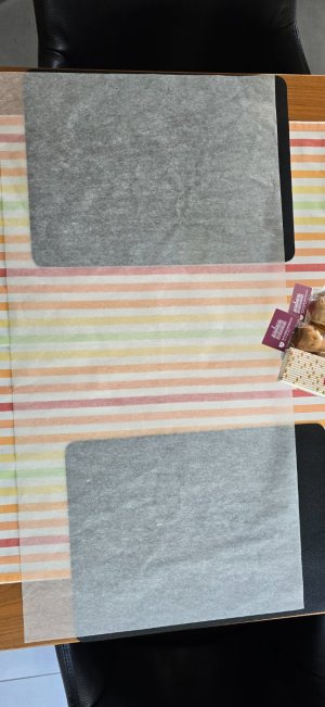

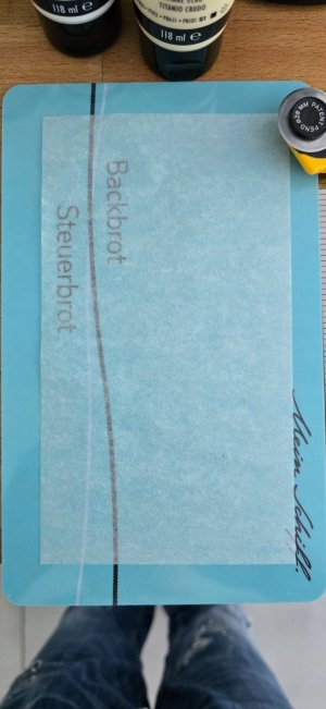

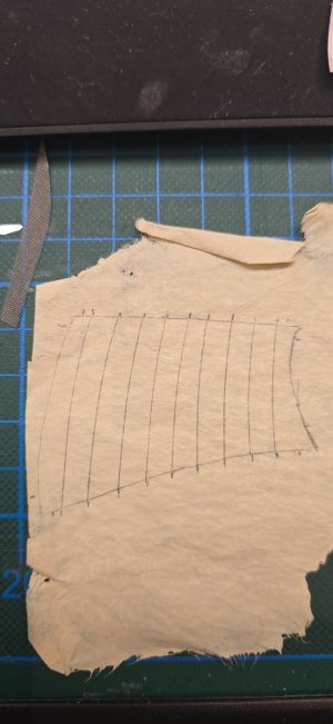

Hey folks,

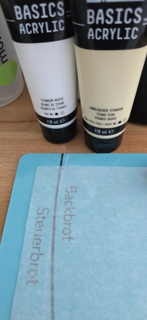

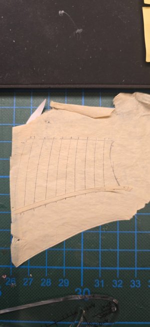

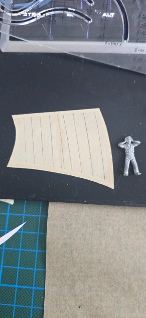

Now I have to write something about my build report again. I thought I'd build the sail for my dinghy. I need a lugger sail. It was quite common for such dinghies at that time.
Steff66 has shown how he makes the sails from paper. Before that, however, he carried out extensive tests on various fabrics and paper. Thanks again for that, Steff, and thanks for letting me rebuild the sails like this. To be honest, I was unsure whether this would work at all, as they are paper sails and not made of real fabric (stupid Günther). However, as I am a lover of detail and don't like it when everything looks a bit clunky and rough, I thought that there might be a method that works, especially for sails. So I quickly ordered the Japanese cashmere paper 11 /mm and the colour that Steff suggested.
I had never worked with paper in modelling before. Even the sight of the thin paper wasn't much fun for me and my fat hands. I hope we will become friends. I rolled out the paper and then cut out a section that I needed for my dinghy.
Then I took a roller and a water sprayer, wet the paper and rolled the paint over it. Unfortunately, I rubbed the roller so roughly that the paper was immediately destroyed. So I had to do it all over again. Cut out a piece again, then wet it and rolled paint over it. This time with feeling. Result: the paper stuck to the roll! After three more attempts, I realised that the roll was simply too coarse and wrong. So I used a new roll, this time made of foam. This went better, but afterwards I had torn all but a small piece of the paper again.
The frustration was great, so I took the small defective piece of paper and pulled it straight off the board and left it to dry. The next day, lo and behold, it was nice and dry and I started the next steps. I drew a template of the sail I needed and transferred it to the paper. Then I put in all the reinforcements and traced the seams. Of course, something went wrong. I drew the seam too tight and straight.
But never mind. This was my first test sail and I even managed to make it so that I can use it for my dinghy. Now I just have to glue and sew on the leech rope. Of course, I still have to do some work on the sail, but I think I can do it and I'll report on it.
What did my alter ego say? "You learn from experience." Finally, I have to say that the paper has convinced me. It is really sturdy and strong and you have to tear it really hard to break it. I decided to make the sails for the Athena in paper rather than fabric, as Tom Lauria describes in his video.
However, I'm using a foam roller instead of an expensive fibre roller and I won't be spraying water onto the paper, but painting the paint directly onto the paper.
Here are a few more pictures.
Best regards
Günther Ship-1
The sail looks great. An alternative is silk span which comes in at least three degrees of thickness so there are choices to try. I have had success with Sig brand and I think it is available from hobby shops in Europe.
