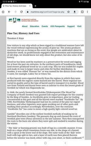

Blackening
Thanks Phil. It didn't explain if "blackening" was pine tar though. I learned about making it when I was into archery.
