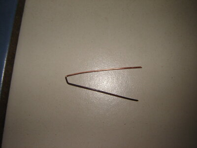

Thanks. When I was writing my post it occurred to me that a quick test was in order. I cut a little piece of wire and heated half of it, then cleaned and blackened as usual. I got this
The blackening took beautifully on the heated side and not at all on the other side. I did a very short blackening treatment. So next I did it again but instead of heating half I cleaned it with acetone. It didn't help at all, the wire didn't blacken anywhere(no picture, imagine a pristine piece of wire :))
So you must be right, there must be some kind of coating put on the wire. I guess I'm going to have to heat the wire before I try to blacken it. It doesn't need much heating, barely enough to start to discolor the metal. Bit of a nuisance but it really makes a difference in the blackening.

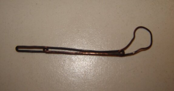

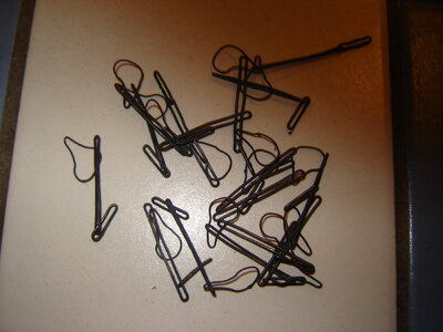

All done. these are the chains for the main shrouds. Not a hint of copper in the bunch. I'm chuffed. I've been chasing that blotchiness for months. Got it now :). There are some coppery looking lines in the picture but they are shadows. Thanks for the help. Sometimes just the act of posting something triggers a thought.
Thanks for sharing. I've had this problem, now thanks to you, I have the solution.
Very pleased to have helped. I follow your build closely. I also discovered that for the little spots that chip off while bending or spots of solder that don't want to blacken that a black acrylic Posca pen will touch them up quite nicely.
