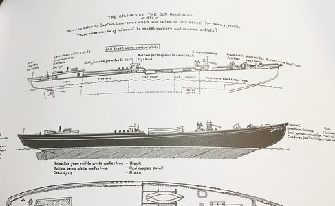

as I understood the hull was painted in "red Copper"
This is also clearly written here:
