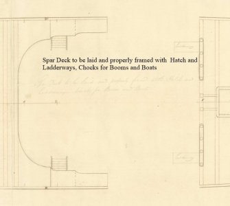

Boat stowage varied a lot over time in the age of sail. The following drawing from RMG for Agamemnon and sisters (ZAZ1282 on their collections website) has a hand written note which is hard to see so I typed it for easier reading. I know what chocks are but I am curious as to their shape, size and mostly location for this case. I always thought of them being secured to the skid beams, but the wording on this drawing makes me wonder. This was a first for me so any information based on contemporary sources would be greatly appreciated.

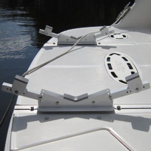

From The American College Dictionary 1966 edition:
Most general definition: "1. a block of wood, etc. for filling in a space, esp. for preventing movement, as of a wheel or a cask."
More specifically: "2.b. Naut. a shaped standard on which a boat, barrel, or other object rests.
Photo shows a modern version. Fair winds!
Thank you very much Andy but I am looking for contemporary 18th century information for Agamemnon and similar era vessels regarding where the chocks were placed, be it on the skids, gallows, QD or FC.
Thanks again. ( I wish I had a yacht that was big enough to have chocks for a tender :) )
TIA

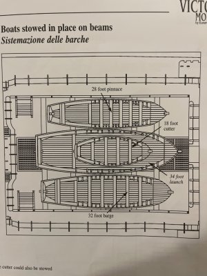

Hi Alan, I don’t know if this will help, but I’m also building a third-rate hms vanguard the ship’s boats are as. Hopefully this will help
Thanks Andy,
I really appreciate you going to the trouble to post the drawings but I am looking for contemporary information. The plans they provided for the chocks may be accurate but based on contemporary boat drawings, there are too many things that are questionable or missing on their boat drawing to feel comfortable with other things.
Thanks again!

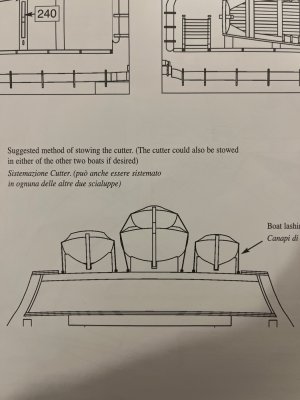

The drawings in post #4 seem reasonable but I have two thoughts: 1) the simplified chocks shown in the elevation view would be easy for a modeler to fashion but don't follow typical carpentry practice. They would have more likely looked something like the sketch below. 2) Many ship's boats were fitted with removable thwarts, which would allow a smaller boat (the cutter in this case) to be nested in a larger boat.
A third thought: like some other furniture and fittings of a sailing vessel, chocks were an everyday feature of life at that time, both on land and at sea. They would have been fashioned as needed of wood and were so familiar that no one would have recorded the way(s) they were made. As modelers, most of us strive for some level of authenticity but in some areas, especially where the item in question likely varied in detail among vessels because of the ideosyncracies of the master and/or bos'n, where the vessel was fitted out, and the availability of materials, we can proceed with a probable solution with clear consciences. Fair winds!
