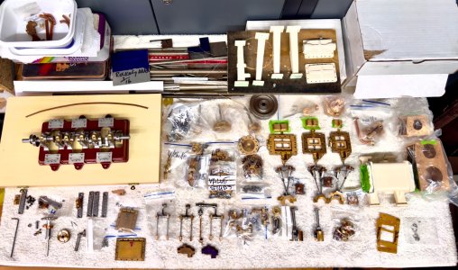

So the first job was to sort through the parts and items given to me in a big box and tins. Drawings supplied are the revised version by J.P. Bertiant, (wow how anyone has ever made this engine using these dwg’s without extensive experience is quite amazing) No datum’s no tolerances and endless chain dims. And a few to many mistakes. But heyho all in the challenge. I have the complete ME walk through from the period which is quite detailed and the new book that’s just been published by E&J Winter for the Bolton No 9 triple expansion engine. This book is again a walk through but differs a little from the original build, im not following some of this books details as i think it deters from the spirit of ME. (Personal opinion)
So having collated materials tools etc. Time to get cracking Thumbsup

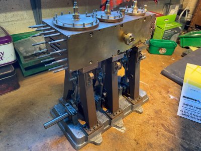

Looking at the build i decided to make the parts to get the engine in a running state. Mick had made all the valve gear but not assembled the IP valve. So i striped it back made a few mods. And basic timing set, the engine turned over by hand but with some tight spots. (Remember this had not move in nearly 40 years.
So having reasonable confidence that nothing major was wrong. I looked at the the first job the reverse gear.

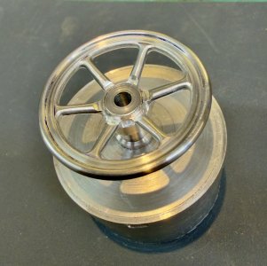

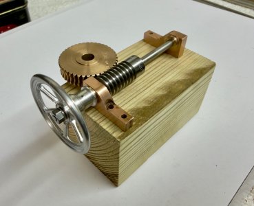

One of the first things Mick said was “please don’t make the forward/reverse wheel ad per drawing!” Which is to roll a rim from 1/8 and then a boss with spokes inserted.. make it solid as it was..! Yes Mick.
So there’s the start point…
Mr Cook was pleased with the first step…

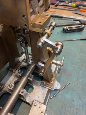

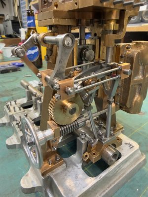

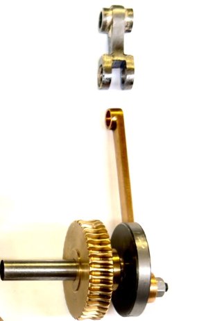

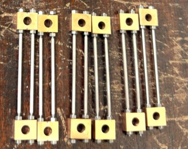

Next up was to make the rest of the FWD/REV link assembly. My intention is to make and fit all the new parts then final finish them on the build.
Link arms roughed out ready for silver soldering…
Drag Links made and then assembled.
Weighshaft operating lever and link arm (which i may remake in steel not happy with the top boss alignment when assembled)
Crank roughed out but not finished
Assembled i used M2 grub screws for ease of assembly and testing operation on the HP cylinder. These are all pinned on final assembly but i may change to keyed as the 1/16 pins do look oversize just a little, we will see..
All worked as it should.

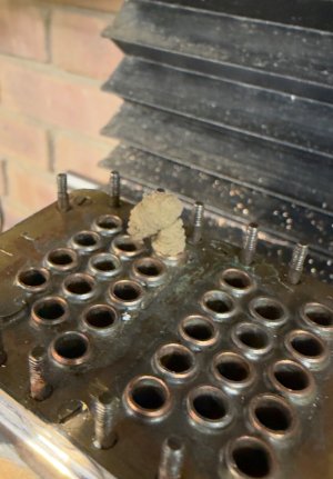

During the fit i had to remove the condenser to machine a flat face for the brackets that hold the worm shaft. As i removed the end cap of the condenser I noticed that there had been a small home built…!??
Clearly someone thought this is a nice secure place to build a house!

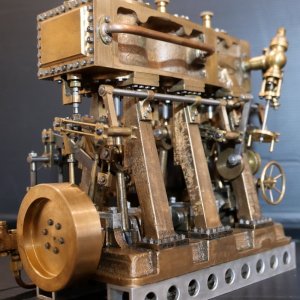

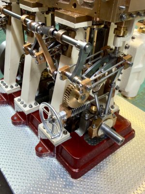

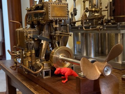

I made a Bolton triple about 10 years ago using the OB Bolton and Bertinat plans, and yes it was difficult. Looking at your photos I can see that Mr Cook and you are doing a beautiful job. Mine was just my third model engine and I did not have a metal working background. But it works on steam and regularly features in local shows, working. I wonder if you have seen the book pictured. It was published a year or 2 ago and is obtainable from EJ Winter, Bathurst, Australia and it is VERY good. I just wish that it had been available when I was making my triple.P1010074.JPGIMG_6173.jpgprop.jpg
Hi John, thanks… yes I’ve seen your engine as you can imagine taking on this half ‘cooked’ pun intended i needed to do some research.
I have that book.. its just been updated last year 2nd edition. There is good info but also as i said somethings in my opinion are not in the the sprit of ME like using EDM to make parts..? when he clearly has the talent and machinery to manufacture them.

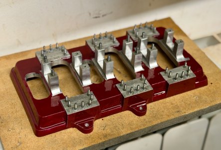

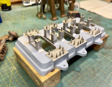

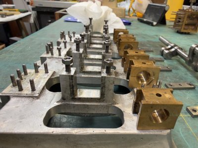

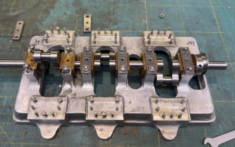

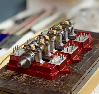

Next job was to strip the engine down remove the crankshaft and main bearings clean the base casting up, drill some holes to fix the base later to a plinth. Also machine a small amount of clearance for the LP valve eccentrics as they are very close to the casting.
Mick has made a stunning job of the crankshaft and main bearings.Thumbsup
Main Bearings are all stamped in pairs but I wired them together just in case.

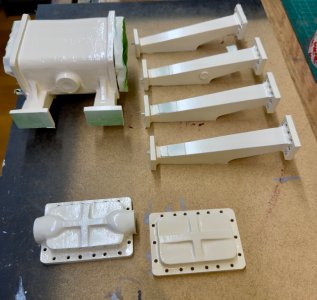

After a good degrease and hot soapy wash some heat resistant etch primer was applied.
Then after a couple of days the first coat of again heat resistant dark maroon, the actual engine castings will be a light cream and machined surfaces left as gun metal, steel etc.

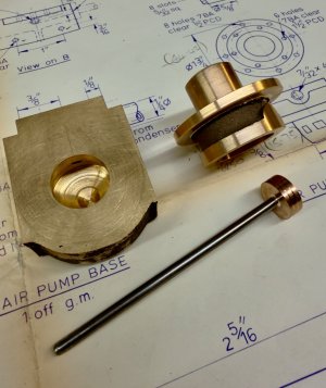

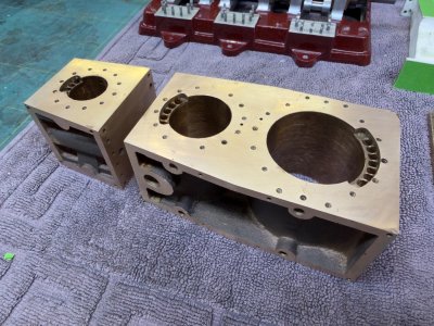

Next job while the paint cures properly ill look at the Edward’s air/water pump assembly, looking at the drawings there’s is a lot of room for error.. again this part lacks dimensions there are again no datum’s so I’ve decided to work backwards and make the pump fit it to the engine then make the linkages to fit. There is a casting that’s in two halved that acts as the pivot point. These castings are not great ,but do give a way to make the pump shafts to be square. There are three shafts in all and they must run true for the air and water pumps to work.

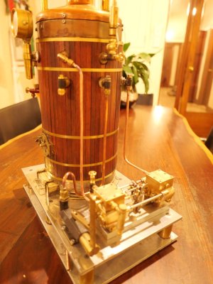

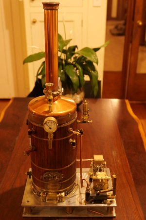

Some pics of my boiler, in response to a request from Kanders.
It is 6" diameter, and propane gas powered, has a hand pump, and a Southworth steam driven pump.
It is tested to 200psi static and 120psi steam pressure, and certified to 100psi.
My triple will run quite well on 25psi, but at that pressure I doubt that cylinders 2 and 3 are barely contributing.
Edward’s air and water pumps, wow this does take some thought Dwg’s are again not great. As I said I’m going to make the pump so that it fits to the engine first.

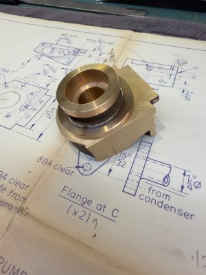

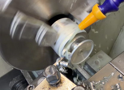

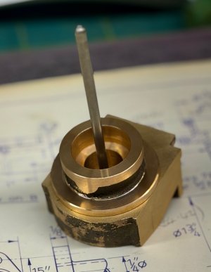

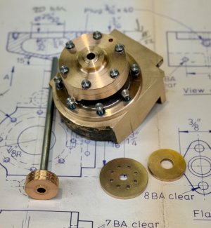

After cleaning up the castings and making a few special boring bars. I made a start, Cleaning up the main datum faces to size square and parallel was key.
So I machined the two side faces on the mill then transferred to the lathe and 4 jaw. Then I bored the body out to take the cylinder and the cavity. Next the cylinder bored for the piston then machined to size.
Drawing has the piston screwed onto the shaft. I decided to make a press fit and the silver solder a ring on the underside.

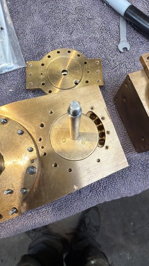

Next made the valve plates and made sure the disc of the valve was just held in position with the plate able to slide to open the valve, all this has to be quite accurate so lapped faces etc required.
Next over to the mill and dividing head for the bolt holes.. big errors on the dwg here but actually plenty of room to get all the holes in. I put a dowel hole at the rear for the cylinder to body

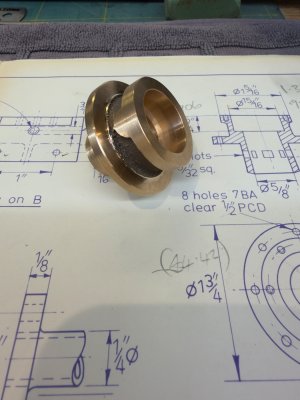

Then the gland nut made, I reduced the sizes for this as looked out of scale per dwg.
Pump shaft needs to be smooth and reasonably free to move. Once the packing is in it will need to be run in a little. Next job add some port holes. I’m not going to drill water pump mounting holes until they are made.

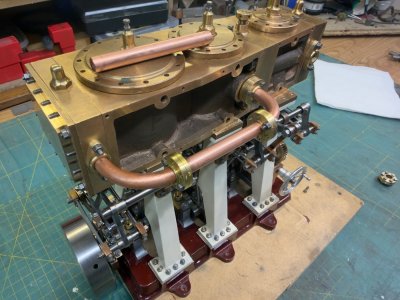

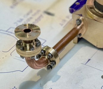

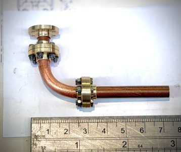

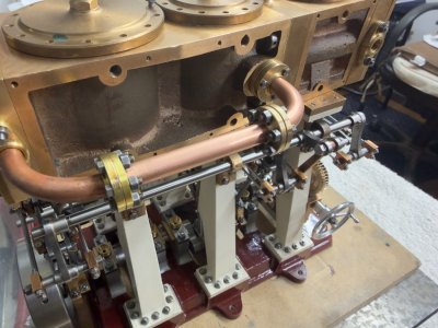

Decided not to just have a bent copper pipe from the condenser, so spent the day making flanges with 10BA bolts nuts and washers. Bending the copper to make the elbow was done by annealing the copper and filing with fine sand, I made a 1/4” half moon in a piece of Ali and bent it round, advantage of this is the pipe stays nice and round..
Next silver solder the flanges and make some gaskets.
Quite pleased with the look.
