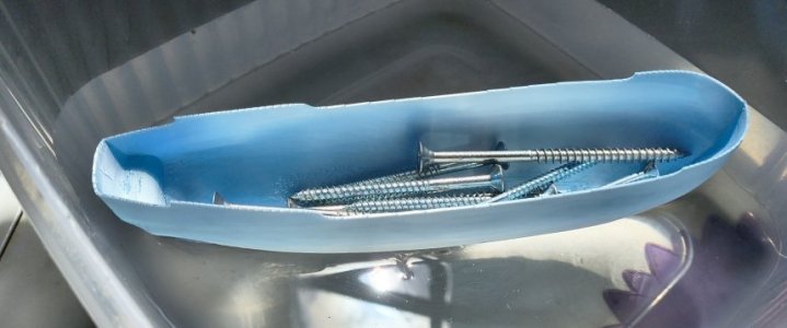

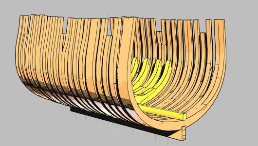

Having a pause from the 1:96 Enterprise, which is close to completion, and starting on the Granado scratch-build.

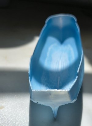

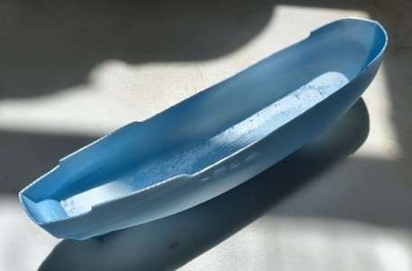

Working in CAD the hull still needs some adjusting but I couldn't resist making a 3D print to see what she is like in the real world. Print will complete later this afternoon........................
I've made the top of the timbers five inches moulded at the rail, but every other model I see, and Goodwin, seem to suggest they are much thicker. There is a notion that they needed to be stronger for the mortars, but I can't see how that would work as most of the recoil would be downward towards the heavily reinforced hull. With the additional weight of the mortars so high above the centre of gravity, it seems that saving weight by having the thinner timbers would be possible? Furthermore, the bomb vessels Comet and Furnace have much thinner top timbers according to Admiralty plans Please do enlighten me if you have knowledge of this subject.

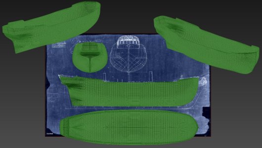

The CAD image below shows the model smoothed and processed for 3d printing. The actual CAD model is lower res to allow for more adjustment......

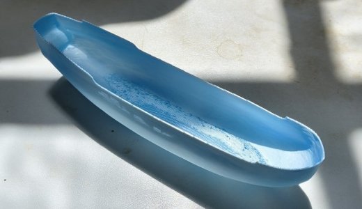

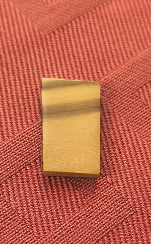

). I've not actually used European boxwood so I cannot make a comparison - but my exotic wood provider says he cannot tell the difference visually and that they process similarly. To that end I don't believe that would solve your problem but I could send you a sample from across the pond if you want to give it a try.
