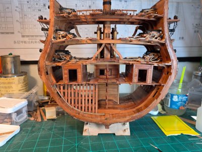

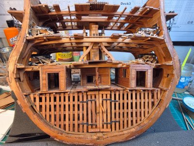

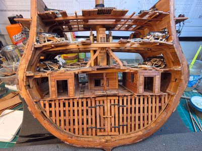

agreeThe partition looks awesome!
That monkey pole behind the partition has incredible depth and looks perfect!

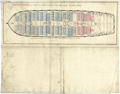

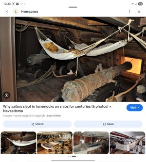

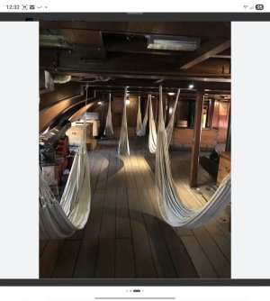

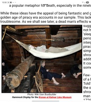

Interesting suggestion. Do you have any image / drawing of how the hammocks will be hanging on a ship of these time period. Will it be parallel to the cannons or perpendicular?This really is a great looking model.Any thought to going an extra meter and add the racks and then rig a few hammocks to them? This is rarely done from what I have seen, but could be an interesting extra.

The images above say it all. Hooks or eyes were used until about mid 18th century, then racks were bolted to the beams and the bridles tied to the racks. In general the hammocks were not hung under hatchways for obvious reasons. If they were close to the edge and the seamen complained about getting a little wet at times they were issued tarps if I remember correctly. Brian Lavery goes into dimensions of the hammocks, types, etc in his book The Arming and Fitting English Ships of War. They may be different for other nations, but I suspect they would be similar if not exactly the same. There are a good number of drawings of the layouts on the RMG Collections website for various decks.
One example follows. Note the minimal space between hammocks.

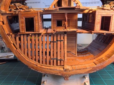

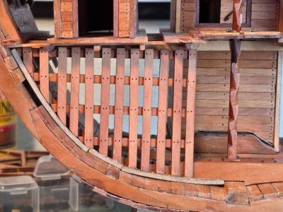

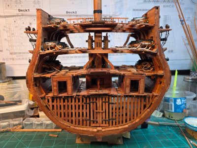

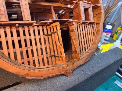

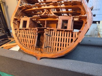

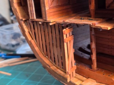

This is a new one for me. What is the purpose of the partition fence? I have only seen solid bulkheads so am wondering what the open slat construction provides. Do you know if this was French construction technique or American? I thought maybe it was part of the original merchant ship design when she was the Duc de Duras. Always something new, and happy for itthe partition fence
As I wrote, on my first posting of the fence built, the kit developer says that it isn't part of the original ship and is left to the modeler to add it or not.This is a new one for me. What is the purpose of the partition fence? I have only seen solid bulkheads so am wondering what the open slat construction provides. Do you know if this was French construction technique or American? I thought maybe it was part of the original merchant ship design when she was the Duc de Duras. Always something new, and happy for it

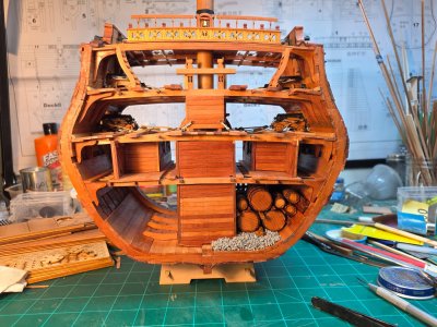

Thank you Grant !!! Appreciate it a lot !!Good morning Daniel. I have said it before however it is worth repeating. I love the look and feel together with the style which you have achieved with this cross section. It's a real ship look vs a model and of course so much busy detail. Cheers Grant

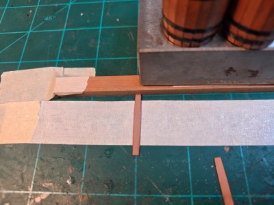

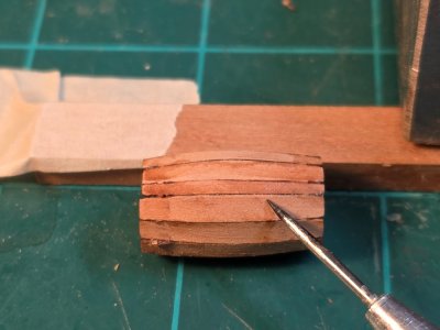

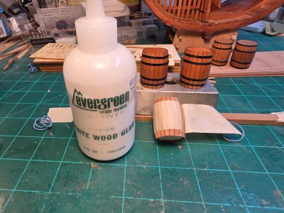

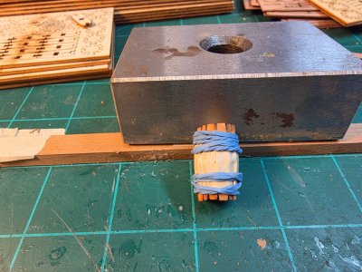

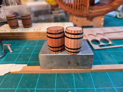

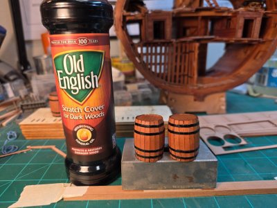

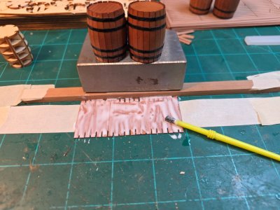

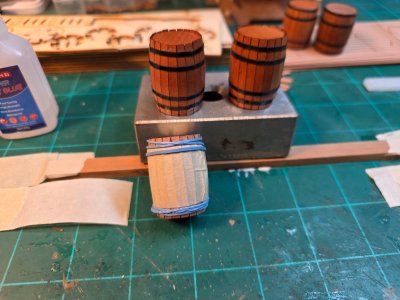

Nice use of the double-sided tape!

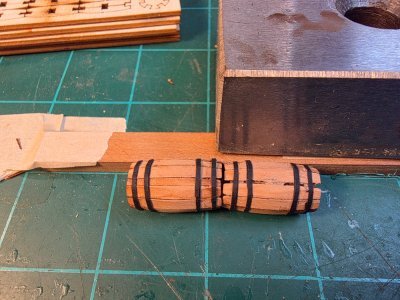

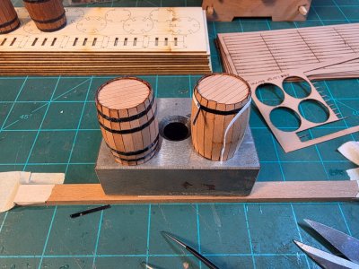

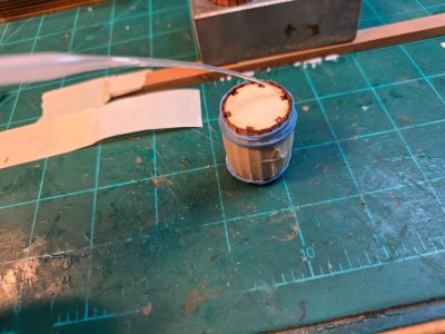

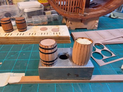

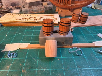

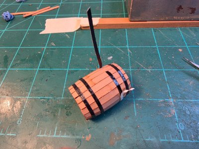

Great tutorial for anyone attempting to build the barrels in this kit.

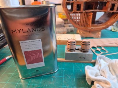

The sanding sealer and Old English added a nice warm hue to the barrels!

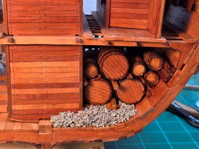

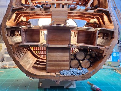

Concerning the partition fence I decided to built it full as deck barrels can be seen from the other side.
