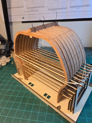

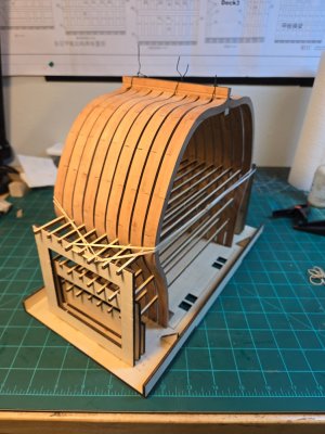

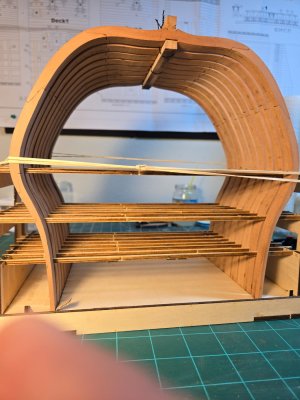

I have started the chain plates and here is my update.
Again, I followed Brad (@BradNSW) construction (see link below). I wasn't able to achieve his built quality, nevertheless I am very comfortable with my outcome.
Post in thread 'Bonhomme Richard - Pear Cross section kit (with scratch duplicate using alder) Unicorn Model' https://shipsofscale.com/sosforums/...e-using-alder-unicorn-model.13555/post-422075
Now I need to repeat all this on the other side :-)
Cheers
Daniel

View attachment 582708View attachment 582709View attachment 582710View attachment 582711

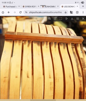

Might be a bit of nit-picking, but the deadeye holes should have the grooves going up to create a softer curve as to not cut the ropes on hard corners.
You might be able to add them with small needle file if you wanted to.
Kurt, I tried, but these deadeyes are made with a kind of hardwoord and when I started I had the feeling I will ruin it all. I took a look to all the builts I had pictures from the BHR builts at this stage. Besides Brad (@BradNSW), all left it round. Brad and you are correct, but I should had taken that decision before doing the first set of chain plates. At that time I thought that such detail wasn't so important, as this built is far away of representation of the real knowled of this ship. So I took the easy way... leave it round. So for these second set I decided to leave them round too.
If someone wants to built this Kit, as similar as the original BHR ship, I will suggest they have to follow step by step Brad, Uwek and Signet builts. Theirs links at are in my first posting.
Being said all that, here is my update of the second set of chain plates. Looks easy, its just a bunch of wires, BUT IT WASN'T !!! I had to redo them several times until I got this stage. This is the best I could.
Below i will post an image of the wire used and nails head, that I blackened. Easy to bend and strong enough to keep the shape.
Here are the nail heads I used as bolts. Yes, Kurt (@Kurt Konrath) I know that they are probable a little big, but this is what I had that looked more or less well. So I used them. :-)
Cheers
Daniel

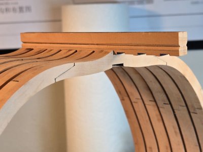

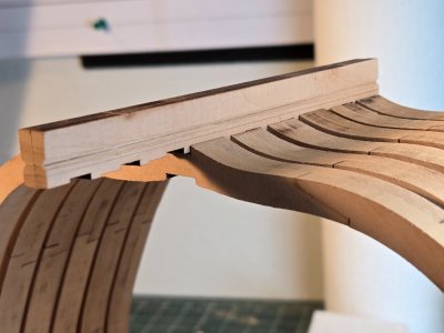

Daniel,
Kurt's comments are better described by a picture. The deadeyes remain round. It is a slight groove running straight up each of the three holes, where the ropes would nestle into the deadeye. It is very subtle. Disregard the red arrows. Instead, look at the slight groove running up from each eye, where the rope would rub and create a groove (blue arrow):
Also visible in this photo:
Hope this is useful.
Daniel,

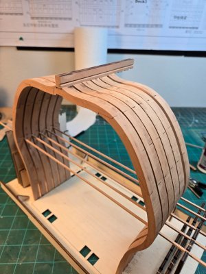

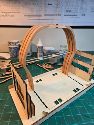

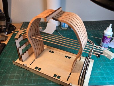

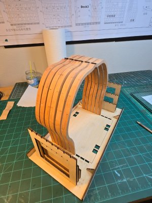

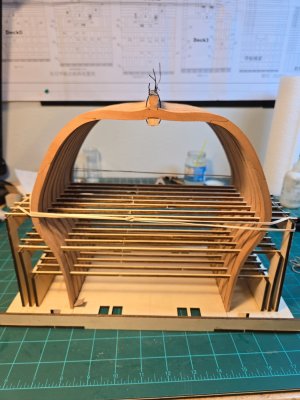

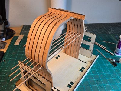

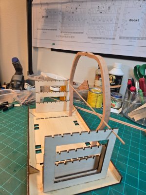

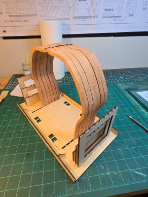

Images are from both sides. 2 of each side. I did my best.
The bigger issue was to find a way to keep the model stable in a comfortable angle for me to work. I remember I had this spong like shaped hull support. That helped, also that my working bench height can be adjusted too. So, working under the magnifying glass i did the job.
Let me know what do you think.
20260308_164913.jpg20260308_175035.jpg20260308_175141.jpg20260308_175312.jpg20260308_175541.jpg
Here you can see how I did the job and the file I used.
Cheers
Daniel
