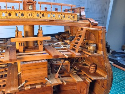

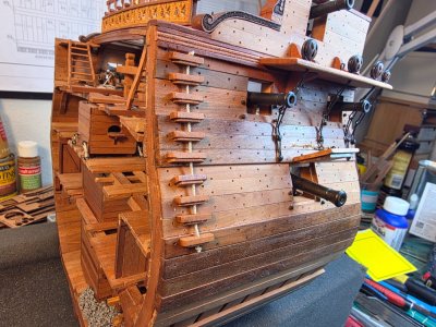

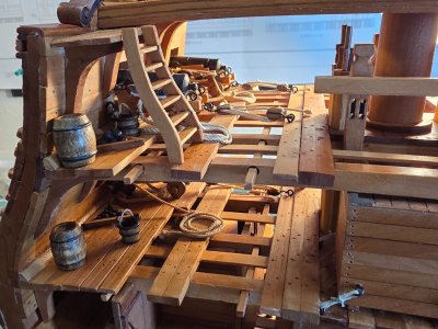

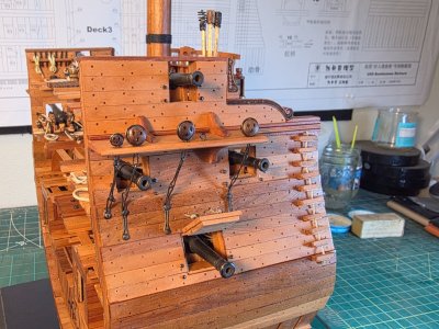

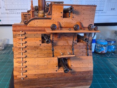

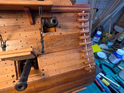

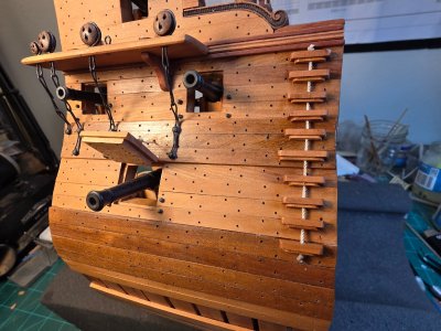

Here we go with the hull ladder. Again, I followed Brad (@BradNSW) My ladder isn't of the same quality, nevertheless I am very comfortable with the results.
Post in thread 'Bonhomme Richard - Pear Cross section kit (with scratch duplicate using alder) Unicorn Model' https://shipsofscale.com/sosforums/...e-using-alder-unicorn-model.13555/post-420222

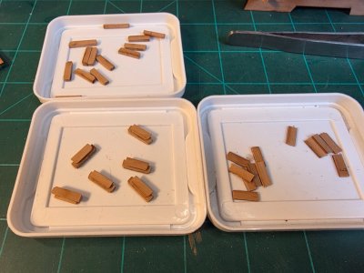

First added a piece of wood under the step provided by the kit.
Then I sanded the wood excess

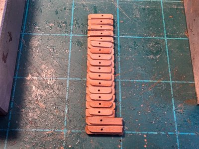

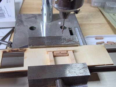

Then I did a jig to do centered holes on each steps
Then I passed the rope and started to glue each step from the top keeping more or less the distance/position of the provided plan drawings.
That is all for today folks. I still have to glue the other side ladder.
Cheers !!
Daniel

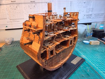

A very nice addition, Daniel. Lots to look at on this model!

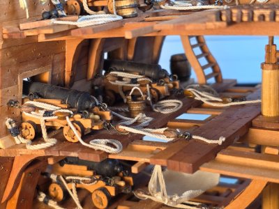

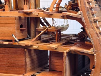

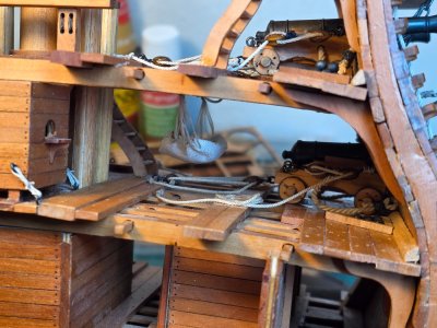

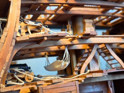

This really is a great looking model. Thumbsup Any thought to going an extra meter and add the racks and then rig a few hammocks to them? This is rarely done from what I have seen, but could be an interesting extra.

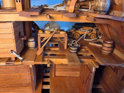

Allan .... I tried to do the hammock. It isn't good, but looks nice when you watch the model from the distance and not zooming an image HAHAHA HAHAHA HAHAHA

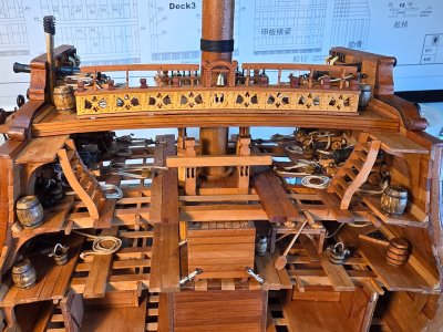

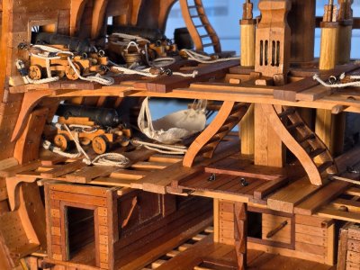

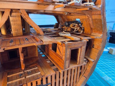

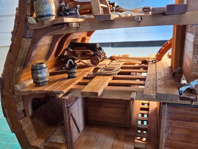

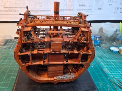

Added the other side hull ladder and a "kind off " hammock :-)
Best !!!
Daniel
Hammock is an awesome addition!!
Thank you Brad !!
I think it looks pretty good and is definitely an interesting extra not seen on other models. Well done.
Thank you Allan !!. It wasn't easy:-) You have to see the previous ones. This was the last one I tried and I said "enough, it is what it is" :-) . Please, don't suggest more ideas of potential additions... HAHAHA
I'm with the other guys - I would leave it as a conversation starter. I probably wouldn't add 20 more, however :).
Thank you Paul !!! I agree 100% -:)
OK for this build, but I cannot guarantee I will stay mum for your next adventure. :)

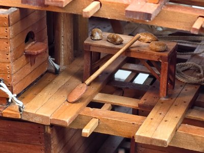

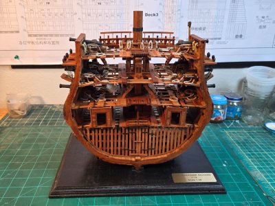

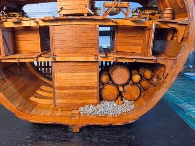

Love the nice glass the cook added to the bread, I can smell the sweet smell from here.
Ladders look great installed, as you said the close ups were showing out of scale closeness of wood grains.
