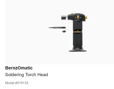

In addition to all the other good ideas, also to Fletch - good idea - I would have never thought of that one. I have thought about getting a torch. Has anyone tried one of the mini torches? I was wondering if this would work.
The mini torch provides a lot of heat quickly, I've used it for soldering larger brass items and it works well. I never tried to anneal brass.
