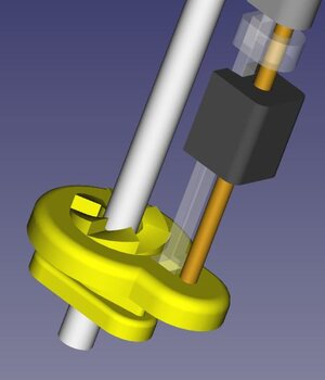

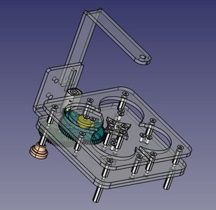

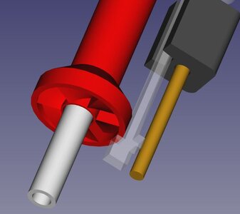

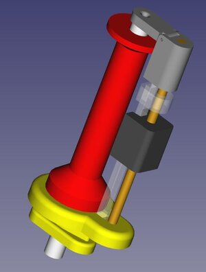

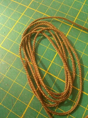

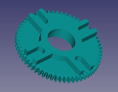

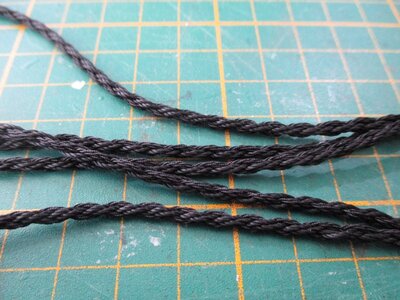

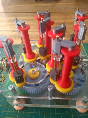

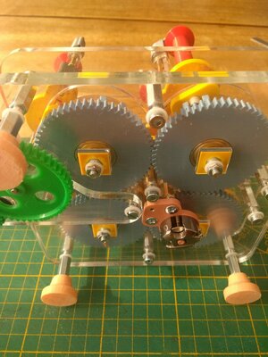

Hello friends,
I present to you the braiding machine that I made using a 3D printer and a laser cutter. This machine produces braids of 8 threads (8x1 or 4x2) with or without core.
Here are examples of produced braids:
I used FreeCAD to model this machine.
Tresseuse-009.jpgTresseuse-010.jpgTresseuse-011.jpgRoue dentée.jpgTresseuse-012.jpg
