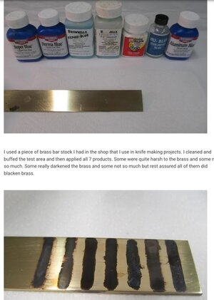

I used gun blueing on brass fittings Just because I had it from a project long ago. It definitely blackened the brass but left a residue that wiped off. The result was an interesting finish of slightly brassy black, perhaps because of the old blueing solution.

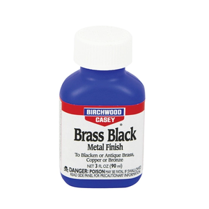

I have used the Brass Black in the past...especially on brass cannons. Not always satisfied with the results. Lately I have resorted to painting brass using various acrylic colours such as flat black, gloss black, and a colour by Model Expo called cannon black. The cannon black has a grey tone to it. To successfully paint brass cannons they need to be clean, and then a thin coat applied so that the paint does not create a thickened look and fill in details. A thin coat covers consistently and allows for all detail to be shown. The paint does not want to overwhelm the part. Anyway...an alternate idea.

I've been trying to buy some gun bluing in town but there seems to be a shortage here. If I have to go online to get it I will get Brass Black.
