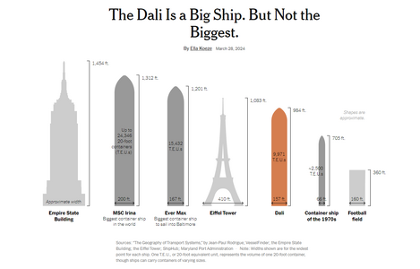

We can see the huge difference in size between old sailing ships and such modern container vessels.
But according the following article the Dali is "only" half of the actual biggest container ships
