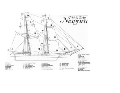

Thanks Dave. Hopefully someone knows it in detail. If I can find out how it was rigged I can go by another ship plan maybe. Or MS’s Niagara but it still doesn’t give me proper sizes.
I have a book at home on American Sailing Ships that may have something useful. I’ll take a look when I get home.
MS’s Niagara kit builds a model of the replica. There are no drawings, half models or other known design information for the actual brig that fought off Put-in -Bay in the Autumn of 1813. The replica doesn’t match dimensions that are known for the original vessel. This is understandable as replica’s that carry members of the public must meet modern safety requirements that of course were not in effect when the original vessel was built.
The MS kit builds a model that is “similar to the brig Niagara.”
There is, therefore, no reason to believe that any unique practices used to rig Oneida are known or were incorporated into the Niagara replica. I would suggest that you rig her in accordance with contemporary rigging manuals. Steel’s Masting, Rigging, and Sailmaking would be a good choice.
Roger
Understood. Im more concerned with having a scale drawing of masting and rigging. Any book I may get won’t give me the sizes of the parts in my scale 1/48. If these Brigs were all rigged similarly any model plan would at least give me a starting point. How it was rigged may be found in the books but not the info I need to build the parts.

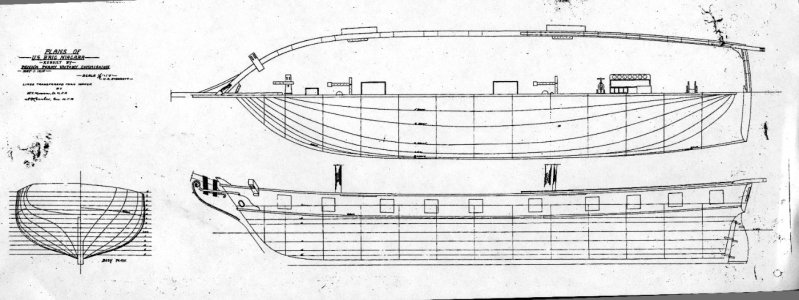

not quite true three are no "original " drawings done by the builders but there is a drawing of the hull done from the wreck when it was raised from the Misery Bay.
here is the drawing taken off the wreck
and here is the reconstruction
pretty close to one another but not quite the same

Dave: Thanks for posting the original drawings taken from the raised vessel. I was unaware that they existed. As a devotee of Chapelle, I was aware of his later reconstruction and his doubts concerning it. I also remember reading an article by someone claiming that the wreckage raised in 1913 was not Niagara but one of the captured British vessels.
Unfortunately when it comes to much of his work, Chapelle is a mystery. Why for example did he not include the cutwater in his reconstruction if it was part of the wreckage? The latest research has uncovered a painting by a British Naval Officer of the vessels anchored at Put-in-Bay after the battle. So, the latest reconstruction by Chrisman of the Eagle now includes a cutwater and head rails.
Chapelle’s reconstruction was done in the 1930’s, approximately 50 years, after the wreckage was incorporated into the original rebuilt Niagara in 1913, so his comments would indicate that key parts of the bow might not have been recovered, and that the first drawing that you posted is of the wreckage plus reconstructed details.
