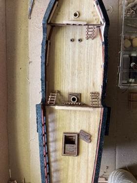

Next I followed the various instructions to make the deck fittings and ladders. Under the hatch covers I painted a black square as suggested by Artesania to resemble the hold. The pictures below show most of these details.
