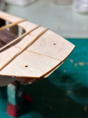

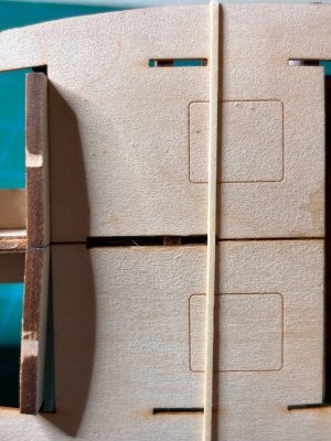

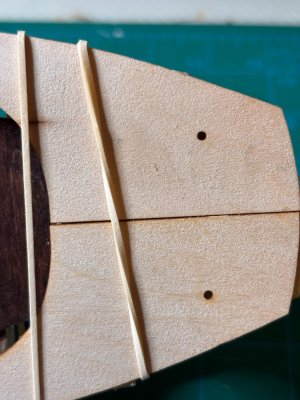

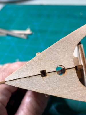

Hello. I've begun building the Lobster Smack (Model Shipways) after completing the Lowell Dory and the Norwegian Sailing Pram. I learned a lot in those builds and am trying to apply that knowledge to the current build. I'm starting this Log a bit late and have already built the spine, the bulkheads and the cockpit decking. I am now ready to dry fit the deck to the frame but I've discovered a problem that I tried to avoid. The spine has a curvature and a twist in the bow (from about bulkhead 3 towards the bow) that will make all further work out of true. Fairing the model will likely be impossible. The curve/twist is significant. It makes the centerline 'off' by 2/16-3/16 inch (toward the starboard). (Please see the photos). I made all my bulkheads square to the spine. I don't know at what step(s) the curvature set in. I made the spine AT ALL STEPS on a flat surface and used a single weight along the entire length of the spine to keep it as flat as possible. All drying steps were 12-24 hours. It seemed to work which makes this problem all the more frustrating.
How can I fix this problem? Can I soak the fore section of the boat in water and try to re-align during drying? Must I disassemble all glued components (bulkheads, spine, cockpit deck, transom) and begin again? Purchase a new kit? The groups advice is welcome.

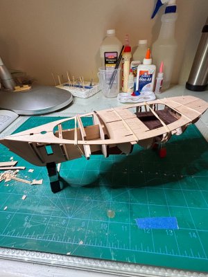

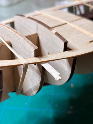

Given that the central spine is made of thin layers laminated together, it's pretty easy to get a bit of a bend on accident. You might try adding some support pieces from scrap between bulkheads. I added a few in my build of this model, as can be seen in the photo, in order to strengthen the hull, but if you get the lengths right, you may be able to use it to slightly push out the side the spine is bent toward and correct the problem. If not, dousing the joints in rubbing alcohol to remove the bulkheads and cabin floor, and the dampening the side it's bent toward and leaving it to dry on a flat surface under a heavy weight, is probably your best bet. Good luck, looking forward to seeing how you work it out!
