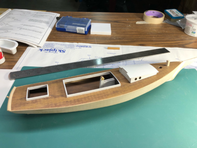

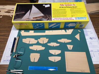

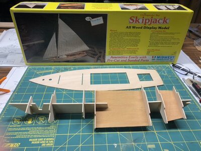

I'm a gluten for punishment often biting off more than I can chew. Not just in eating but model building as well. I have decided to build at the apprentice level (where I should be). Recently, I was rummaging a Antique/Flea market event and ran across an unopened "Skipjack" model. Nothing fancy but definitely a project to get the juices flowing again.

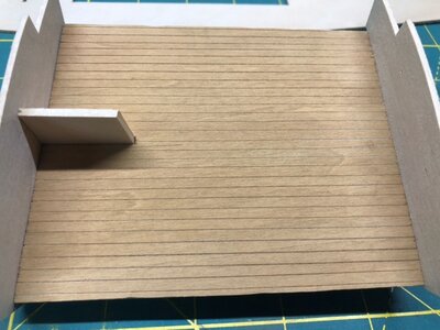

Nothing much to report with first few steps. Easy to remove pieces from sprue, minor blade work, a little touch up sanding and the haul takes form. I did spend some time mixing up acrylic was for the deck pieces. Measured 1/8" gaps and scored the wood three times with the blunt side of the exacto blade. Lightly sanded in the direct of the score marks with 500 grit SP then light brown acrylic paint applied with a paper towel.
Once again, It's good to be building again. Will return to the Connie project at some point.

Nice work on the deck. That’s an interesting technique you used. Why acrylic and not stain? Curious
Thanks Epicdoom,
I recently decided to change the deck color to light mahogany although the stain inadvertently brought the basswood grain through botching the scale effect a bid. It will do for this quick build. This weekend working keel and batten chines and moving on to planking the haul.

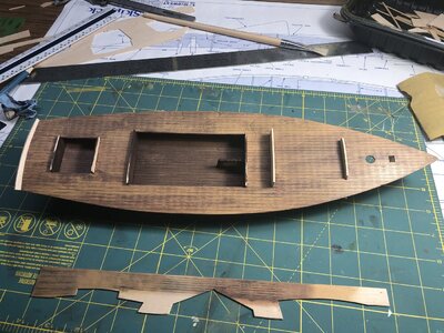

Test pieces are very important. Sometimes jumping in and committing to a color scheme isn't a good thing. Better said, "NEVER a good thing". Below is a piece of scrap I played around with scribing and staining until I found the desired affect. Not my usual rush, rush approachSkipjack 4.jpg. "maybe I'm finally learning something"!
I see what you mean by the grain coming through. I don't know how much of a test would have prevented that. There's really only about 5 bits all along the port side that the grain is prominent. I don't see any of that in your test piece. I think the overall look is still very nice. I really like this colour you're chosen.
Chris,
Minimal grain issue and will go with it. Thanks for feedback!

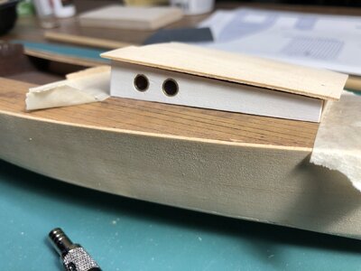

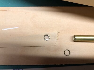

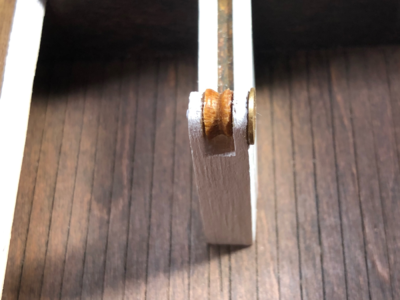

The next set of photos show my attempt at simulating mortals in the forward cabin. There are a few Skipjack day cruise websites with plenty of reference pictures that show usage of forward cabin for leisure vice dredge fishing, which the Skipjack was designed for originally. I'm opting for accommodations.
Photo 1 and 2: Test piece shown with portal installed. No more than your local craft shop jewelry section which I still have some apprehension of being seen by a fellow leatherneck! LOL
I use a brass tube, sharpened at one end to cut the hole and this plastic for the window glass. The look is acceptable and gives appearance to scale. The cabin side frames with be white.

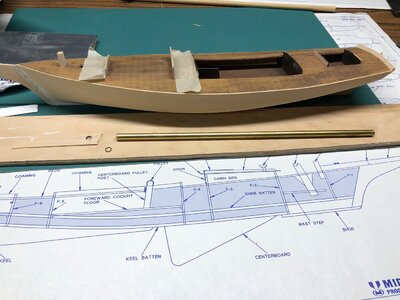

Photo 3: view of hull side plank and bottom plank sections installed.
Once again, the Midwest Kit is a great place to start for first time builders.
Take care all!

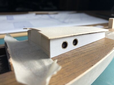

Portals complete on forward cabin. I thought about cutting out the deck under the cabin and makeshift a modest interior. But, will try to keep this short build simple. We shall see, still undecided.

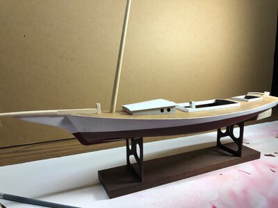

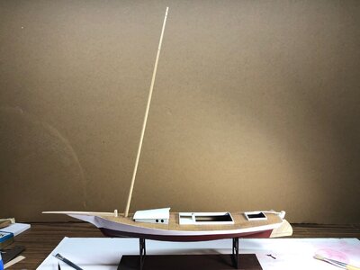

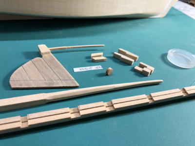

Back on the build again with the holidays giving me some free time.
Hull and deck. No major surprises given it's a very simple kit.
When I opened this photo I notice how awful the sanding and painting effort truly was..... We'll clean up during touch up.

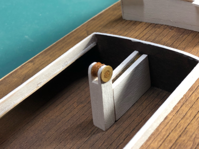

I made the pully from a bamboo chop stick I found in the shop scrap wood pile. Always keeping something that can be used for modeling!
Chopstick, Top Center
Last photo of piece parts under construction. I'm learning the importance of following directions and reading steps if there are any doubts. Usually not my style, "Just wing it". SOS Staff and Members, "Thank you for all the inputs and keeping the hobby going!". Hope you enjoy the post.
