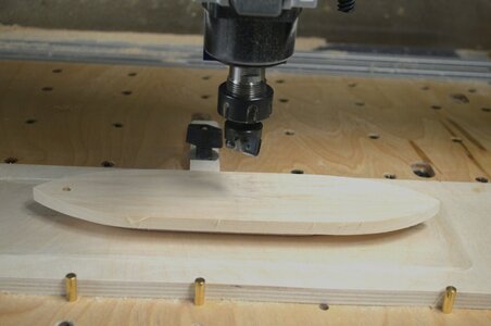

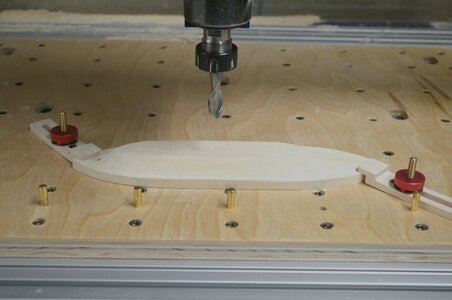

Took a .010” skim cut on bottom of hull to verify surface was flat
.015” cut off top prior to “Scribing" of deck.

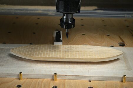

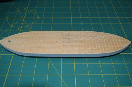

30 degree .005" flat tip engraving tool to scribe the deck

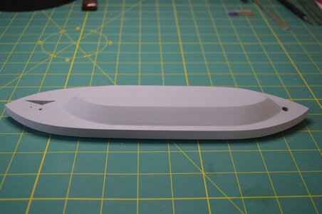

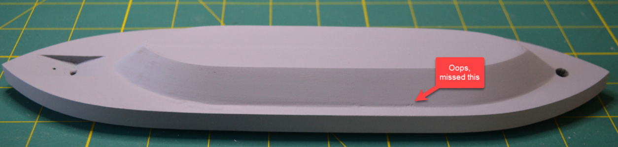

Sanded and primed the hull with grey filling automotive primer then wet sanded with 320 grit. Saw a couple of spots that needed a small amount of spot filler. I use 3M brand green glazing putty. Re-sanded, primed and sanded hull again in preparation for painting
Oops, had to fill, sand and re-prime the hull

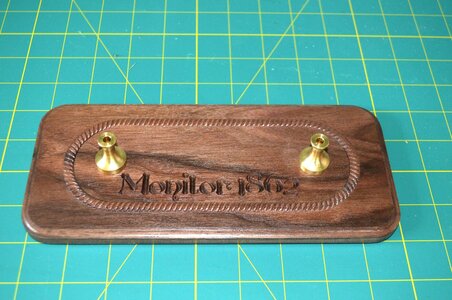

Made pedestal from Walnut and cut rope border, edge treatment and engraving on my CNC.

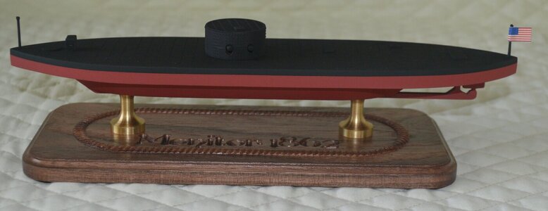

Above the waterline painted with True North brand flat black & below waterline painted with True North’s anti-foul red. Propeller is Krylon Antique Bronze. Masking done with 3M Fine line tape which leaves no bleed through and removes w/o lifting any paint.
Coated entire model with Kyrlon Acrylic Matte finish.
