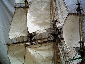

I build Montañes about 20 Years ago, as well as Ntra. Sra del Pilar. I still have the instruction manual in digital form. have about 500pictures, drawings, schema, etc. You are welcome to come back here or on my E-Mail address: peandersen@telefonica.net. I have here in the last days made -together with Done- some comment of Riggen, and the IMPORTANCE the sequence of making it. have built this type of ships about 40 Years. Last one Soleil Royal. Generally, I will say, Montañes has the same riggen (the Oriental one) which is different from the British Warship. mainly the lower mast. The rest is more an less the same as you change to another car. there may be some minor difference- gearbox- the rest more and less the same

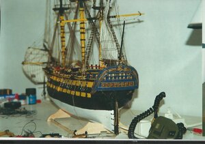

Yes in one way. Montañes was 74 gunship from late 1700 beginning 1800. The main difference between the British 74 gunner and the Oriental ones- Denmark/ Norway-France and Spain -was ringing, mainly of the lower mast and Yards -apart from Guncarrige and the ringing of guns. I have built one British "the Victoria" and 5 of the Spanish 74 gunners known at the Trafalgar Battle and Norske Love and Holsten in the Battle in front of the Naval port Copenhagen 1801. Apart from this minor difference- many builders are mixing them up they are all rigged nearly the same.- pics are 1: montañes. 2 San Juan Nepusano 1998. 3 Victory - my 1Th. build of a big warship 1993-9525.jpgB S. Nepusano.jpgbarco1.jpg

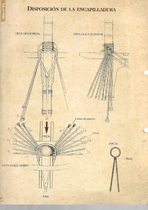

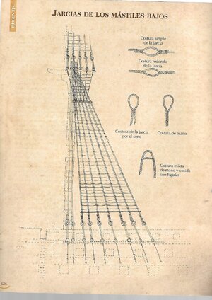

HI. I build this ship in late1980th. I have a lot of information, but you should have riggen instructions fairly well within the instructions comment with the kit. iIf not You can download it from the OcCre www.side
To start the Riggen the right way is VERY IMPORTANT.
1Th You start with the standing Riggen, starting with the Shrouds first _ on the lower mast -see my info under riggen. Once the Standing Riggen is done- which will take a minimum of about one year, Then you start making the Running Riggen, which differs if you want to make your model with or without sails.
below you will find some images. If you need help you are welkomm either here or over the private line
