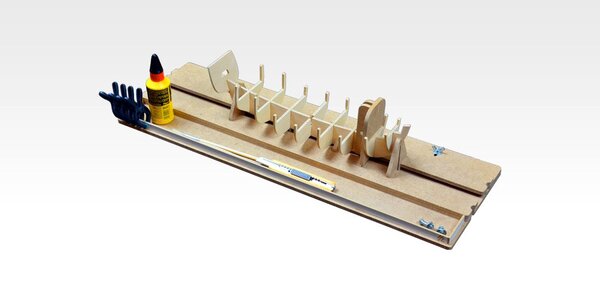

I have come across a building slip from Billings Boats, which seems very similar to the Fair-a-Frame building slip that has all kinds of mixed reviews online. So I'm asking the group, is this a useful tool for a first time builder ?
Hallo
I do not use any of these building slips, but maybe I can give a hint based only on looking at these slips
Billing boats - price around 50 Euros - length of models up to 90 cm

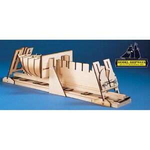

Model Shipways - Fair-A-Frame -> price around 50 US$ - length of the base 61cm
With both slips you are limited in such a way, that the model is every time fixed in the vertical direction, means you can use it for the rectangle installation of the bulkheads and to fix it if you are working on the decks etc.

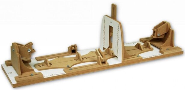

Somehow similar Hobbyzone is offering a small slip for half of the price - models up to 80cm

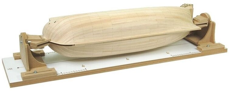

But take a look at the second slip from Hobbyzone which is looking for me more flexible - possible length of a hull with 100cm - price around 53 Euros
You have the same possibilities, but in addition you are able to rotate a fixed hull through 360°

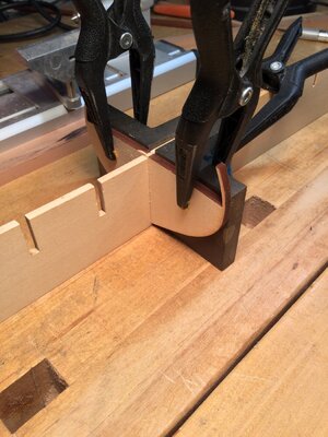

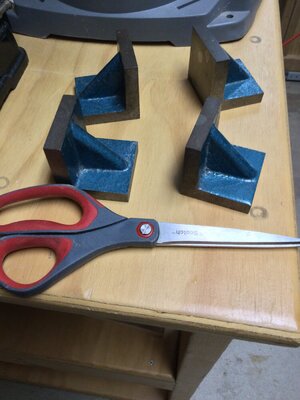

I bought the Model Shipways "Fair-A-Frame" for my first build years ago. I used it for about 1/4 of the frame build. Then I went out and bought four machinist's right angle set up blocks and never looked back! The "Fair-A-Frame" went into the trash (where it belonged). If you look hard, the blocks can be had for $5-$15 apiece. Not cheap, but they'll last your whole life and NEVER EVER go out of square! Just my 2 cents!
Thanks for the links Uwe, I just ordered online. At least I think I did, I'm pretty sure the web site was in German. Anyway it was only $57Cdn with free shipping and I paid with Pay Pal so if it's a bust I won't loose out.
I have seen those types of angle blocks in 1", 2" & 3", what size would you recommend ?

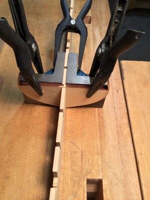

If your going to buy them, get the 3" size. They are very versatile. Mine are 2" and they work great, but bigger is better with these. If you were building a frigate in 1:48 you'd really want the 3" size, but the 3" blocks work fine for a 1:96 scale build too. The 3" blocks are heavy, also. I use them as weights to hold frames tight to the keel/rising wood in plank on frame scratch building.
Here is how I use them to glue up a frame truly square. The model is 1:64 scale:
