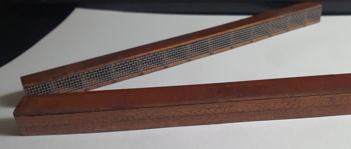

Well I have brought the front lifeboats inboard and removed the smoke stacks that the kit proposed (I checked every photo I had and they were nowhere to be seen). The lifeboat are a bit higher than I would have liked and as indicated on the photos but my staircases (which I like) sort of demanded this to be in any way realistic. Now the davits, I have provided for supports on the outside of the lifeboat supports but this will mean modifying or replacing the kit davits. we will see. - I think I will use different davits to those in the kit for the front lifeboats

Well this was obviousely too big & even after a clean up definately not what I wanted or what repesented the ship. So I rebuilt it at a smaller size and simpler
