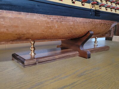

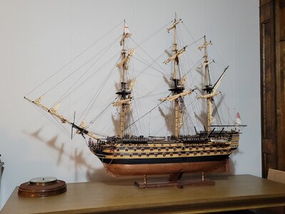

Thank you Jimsky for posting the link on how to build a boat stand by Olha Batchvarov. It worked out well, even for a large model, like my 57" long HMS Victory. Next will be the display case.
