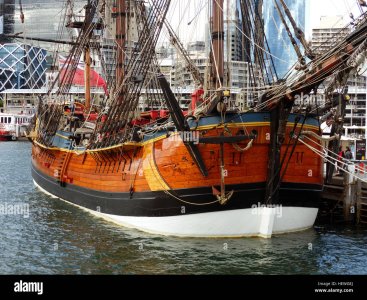

Are you sure she carried bumpkins? Marquardt's works are fantastic sources, but I can find no evidence based on contemporary sources that she had any bumpkins. Endeavour was a converted Whitby collier, which featured a broad, bluff bow. As a result, the catheads were positioned to point nearly forward and served to work the anchors as well as serve as a convenient, point for the fore tacks, eliminating the need for bumpkins.
If you look at the contemporary drawings of her a on the RMG site, there appears to be no need nor room for bumpkins. MAYBE she still had them but there is no evidence there. The replica in Australia, which many consider an accurate copy has no bumpkins. Your choice, but if you do not add them, you have a lot of evidence that they were not on this ship.

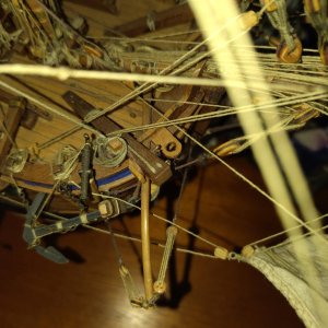

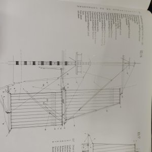

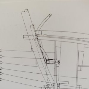

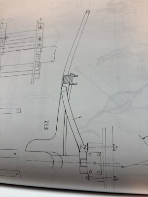

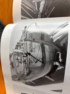

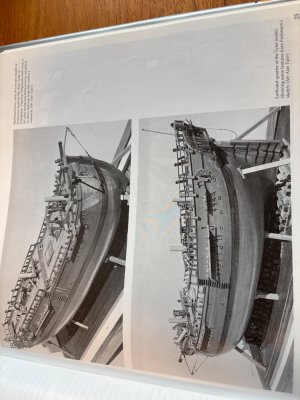

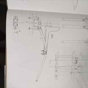

I hope my photos get through. This is the model built by Alan Tyler based on Marquards book. As you can see the cat heads appear to be more athwart ship than pointing forward.IMG_0333.jpegIMG_0332.jpegIMG_0331.jpeg

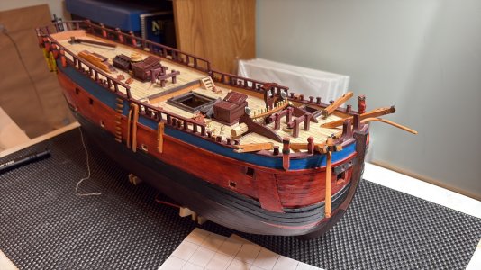

I added them on the Endevour I made soame years ago based onthe book anatomy of a ship Endevour. It really is a matter for you to add or not to add. There is no one alive today who was there to actually tell you the correct answer. The book does make mention and provide details.

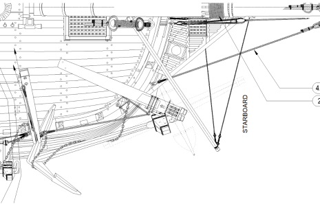

The evidence of Endeavour carrying boomkins is here in Parkinson's sketch.
Regards Allan Tyler.
Although Karl and I agreed the boomkins were there I had a bit more faith in Parkinson's sketch proportions. The ends clearly come below the hawse holes. They were meant to be low to keep the tack of the sail down. The boomkin shrouds are another issue and I would change their anchor points.
This keeps them well away from the anchor cable.
Here is Investigator's boomkins.
I like very much. How did you make them? As they have a square base that fits into a fitting on the deck and then become round. Im thinking of some square stock, chucking it in my drill and sanding it round, then soaking it and bending it to the correct angle.
Thats pretty much what I did. While you're at it an interesting feature you may want to add is the toilet seat next to them on both sides. You would have had a great view in the morning but depenting on wind condition you may get more salt spry than one intended. Or worse....

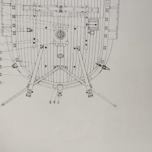

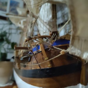

Thank you very much. How did you attach them to the deck, I can't see how in your photo? I have noticed that you included the "probable" lower fore studding sail boom. Would you be so kind as to include some photos so I can determine if I wan't to include them.
sorry forgot the picture.
Are those the extensions with the round hole? One would think these would be aft of many other parts of the ship. Wouldn't want to haul in an anchor or sail if you know what I'm saying. Best to be over the captains window. Let him know what you think. Good day mate Thnx from the colonies.
From the book I mentioned details of bumpkins. The last picture is of the studing sail shown extended. I didnt do it this way as Iwould have needed a much larger space to display the model. Im not really clear what you were refering to in your post aboutthe studding sails in the picture I sent. The thing with the hole in it really is the ships toilet. It would be worht your while to obtain the endvour book if you want to enhance your model.
