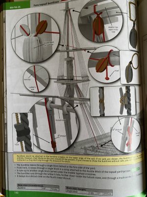

im scratch building a clipper, flying fish 1:96. im bitting off more than i can chew with details by installing bunt lines... but im not putting on sails.
my question, when sails are removed or going to be installed... how are bunt lines left on the masts? do you leave a bundle hanging at the end of the ropes at each block? how much line should i bundle?

So! Buntlines would not be rigged on a ship with bare yards (without sails).
