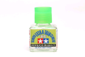

I am not sure what tasks require to use CA for plastic modeling, but Tamiya made excellent glue\welder. It is like a watter, and can penetrate easy while parts already set in place. It is drys fast and holds strong

With that said, I am with Jimsky on the Tamiya plastic cement. NOTHING beats this stuff. It literally welds the plastic together in seconds. If you are gluing together two halves of an airplane model, you just touch the brush to the seam and the thin glue runs down the seam and immediately welds as it dries. Amazing stuff. Try it.

I watched a you tube video of a guy who builds custom model cars to take to shows. He builds them with Ca because if they get bumped or dropped the glue joint will break instead of the part breaking, which make for easy a quick repair. Tamiya welds the parts, and the part will break instead of the joint breaking.
