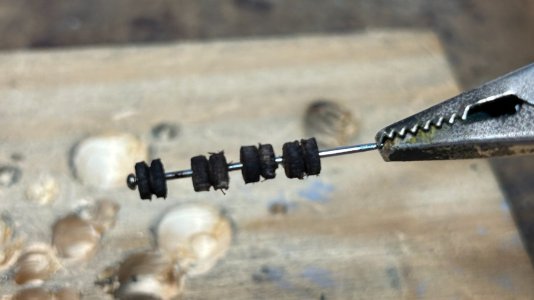

In R. C. Anderson's book "SEVENTEENTH CENTURY RIGGING" at the end of the first chapter it is written that the girth was a little more than half the diameter of the mast. You can rightly argue that Anderson wrote about ships of the 17th century, not the 15th, and you would be right, however, of the books that I have, only this one clarifies this point: neither Hockel, nor Mondfeld, nor Kurti write about this.Book "The ships of Christopher Columbus", drawing of Santa Maria by Martinez-Hidalgo:
View attachment 440450View attachment 440439SM drawing by Mondfeld:View attachment 440447The Niña model built by Evgeniy Tropman (he is a serious researcher, I completely trust him):View attachment 440448View attachment 440449In R. C. Anderson's book "SEVENTEENTH CENTURY RIGGING" at the end of the first chapter it is written that the girth was a little more than half the diameter of the mast. You can rightly argue that Anderson wrote about ships of the 17th century, not the 15th, and you would be right, however, of the books that I have, only this one clarifies this point: neither Hockel, nor Mondfeld, nor Kurti write about this.
In principle, you already did it well, it seems to me that there is no need to redo it.![]()
