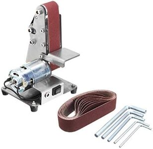

Greeting all, indeed charr removal is quite a pain. Here what I do now... With harder wood, such as boxwood (maybe pear, walnut and cherry), you may have to use harder particles (aluminum oxide). A little expensive, but what is not in this craft? Link below provided alternative from recent posts.
