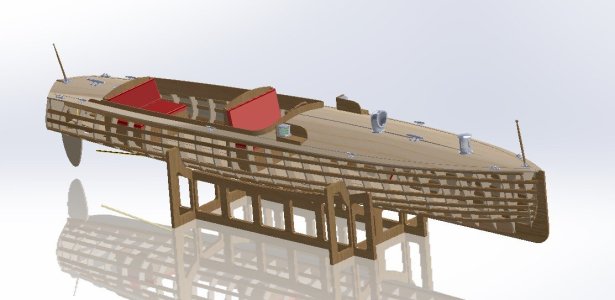

I am working on a redesign of one of my frame sets and thought you might all get a kick out of a new approach I am taking.
In this design, the shape is created in a dedicated software that works well with organic shapes and then that part is inserted in one of the "usual suspects" for CAD for manufacturing.
But that is not important. What is fun is the resulting details that I have been able to introduce to contemporary kit design.
In this case, I have done the following:

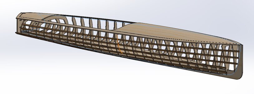

- doubled the number of frames that were in the original drawing. Remember, since I am working off of a 3D hull shape, I can add bulkheads wherever I want, and in any orientation.
- opened up the cockpit area in preparation for including seats, fixed and 3D-printed, as part of the kit
- added stringers to give the model builder a more accurate, and enjoyable, build.
This is an ongoing project. I will add a few more pictures later, as I get closer to cutting the parts.

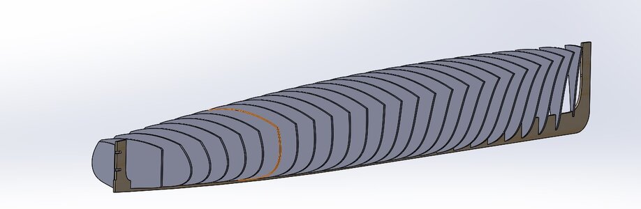

Well, getting those stretchers to line up nicely was quite a challenge. I have to say, there's probable a solid twenty hours that went into trying a variety of features in the software to get this right.
The difficulties come from two things. First, the software doesn't "know" that I am cutting these parts from 3mm plywood. The second is that a hull shape does not twist evenly from the stern to the bow.
For the first issue, one cannot simply send a "cut" along some path to cut the notches in the frames. Such a path would follow a 3D shape and would cut the frames precisely along that path. That sounds nice but, of course, we don't cut the frames in 3D. They are cut on a laser on a flat surface. So, if we simply send a cut in 3D, when we lay the parts on the cutting table, the laser will see a whole bunch of lines where the cut goes through at some weird angle.
So, I had to figure out how to get that path to work, but the laser to know where to cut so the builder can install the stringers with the least amount of fiddling. Obviously, the builder will have to to some sanding to get the stringer to follow the shape of the hull, but the idea is to keep that to a minimum.
Also, when I did the first "insertion" of the stringers, they simply did not look realistic. I went through many, many iterations to get the look I wanted.
Now, we have a wonderful, revolutionary, method of designing and fabricating boat hulls!

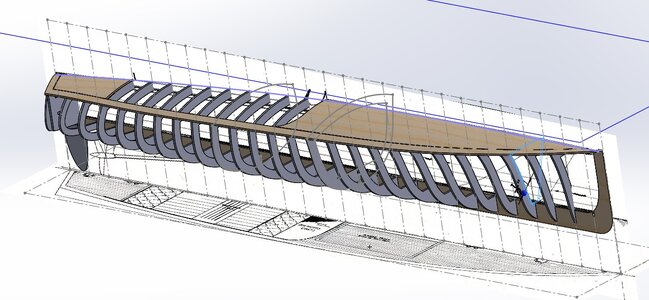

In this first picture, we see a couple of these "cuts" that the software will do easily enough, but that do not work for what we are trying to achieve.
In this second photo we can see the insertion of the sheer plank. The software will twist the plank along the path, but the twist is "even" all the way along, which is incorrect for a boat sheer plank. We need to figure out another solution.
This picture is a bit out of order. It shows the stringers in place, with the notches all done, and it also shows a garboard strake that I have added. This plank does two things. First, it acts as a "landing pad" for the lower planks and it also strengthens the keel considerably.
Another picture that is out of place. I am now building up the internal surfaces of the model. Here you can see the rear seat installed.
The picture below is an interim picture. I was certainly not happy with the stringers following waterlines. That just didn't seem right, or realistic. I tried a number of strategies to work the stringers into a realistic arrangement.
Finally, the stringers look pretty good!
Here is a nice bow-on view. You can see the smooth curves that the stringers will make once you build this model.
This picture show how many lines the laser would be looking at if we just used the cut path that the software wanted to use. I had to find a completely different strategy to make the cuts work properly.

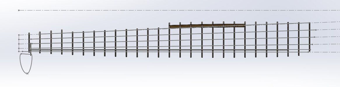

I have continued the design of this model. I now have some parts designed that will be 3D-printed and I have started the design of the T-rail. At 42", this will be a good model for those of us whose eyesight is weakening (and for those who want their models to go in the water).
The first picture shows the T-rail positioning on your workbench. The second picture shows port and starboard bow chocks. The third picture shows the rear bench. The cushion will be up to you!

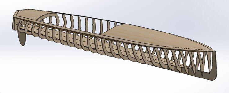

Now that I doing the laser-cutting layout, I am looking at various 2D views of the model. This picture really shows the interesting, twisting, notches for the stringers. Note the notches on the starboard side, and my 3D "stringers" on the port side. The basic kit does not include planking, although it does include several 3D-printed parts.
The picture also shows one of the parts of the cradle that will come with the kit. Since I design the cradles right off the 3D model, they fit very nicely.

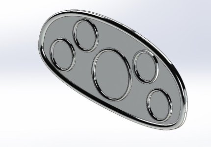

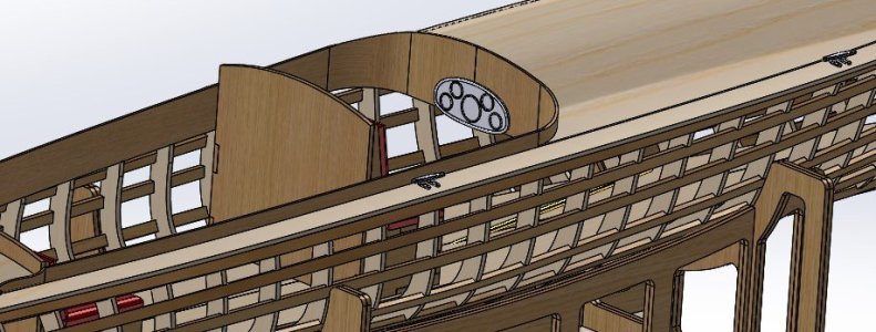

Sorry for the delay. I was working on a 1:24 scale Lionheart. But, here I am back again continuing the Charles Mower design. Here I have inserted the dashboard. I have to say, there are dozens of designs to work from, and what I think was correct for the Charles Mower, was a simple two-dial job that sat well under the dash. I have opted to make something a little more snazzy.

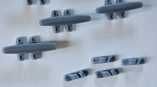

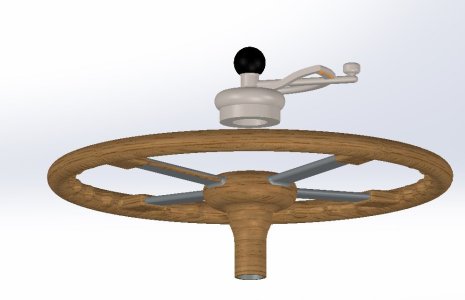

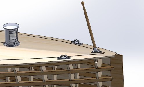

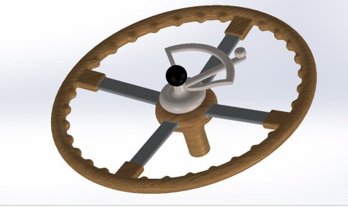

I did a bit more work on the Charles Mower design. I have now created all the fixtures I want to include in the kit as 3D-printed parts. The lights are created as two-part assemblies, so the builder can include a lighting kit. The steering wheel is made as a two-part assembly so one can insert a threaded rod and use it as part of the steering mechanism.

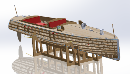

I figured out a solution for the cutwater and I think it can work. It will be an optional part. If you decide you want to give it a go, there will be a laser-engraved line on the forward edge of the keel, to show you what you would have to cut off to get the piece to fit.
The kit is now ready to go and will include the following:
- frames with notches for the internal stringers. These are made in 1/8" birch plywood
- a deck with a correct opening for the cockpit. This is made in 1/16" plywood so it can bend easily over the deck shape
- the T-rail structure so the hull can be planked up-side down. All my designs have these T-rail structures. They make the hull solid and really hold it straight during the planking process
- the cradle you see in the picture below. This will be used once you take the model off the T-rail in order to work on the deck
- the following 3D-printed parts:
- vent
- cleats, large and small
- flag stanchions
- light fixtures
- steering wheel
- cutwater. I may give two different cutwaters with the model since I am not sure how this will work. It will be a "work in progress" and modellers can help me decide whether it's worth it to create such a part, as a 3D-print.

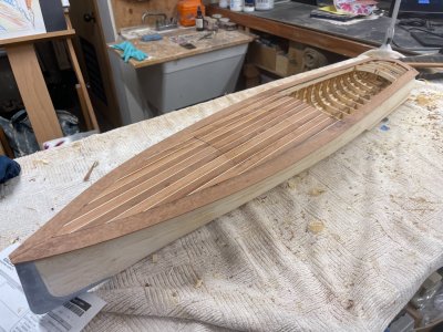

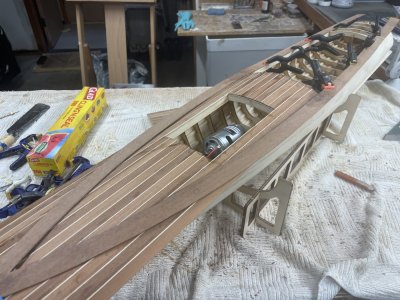

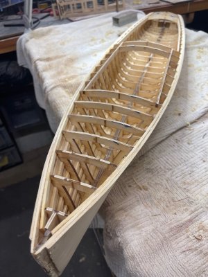

Hurray, this model is now under construction, and I have sold several kits already. The framing kit is laser cut, and I am now working on a timbering package for the model. The 3D-printed parts package should follow shortly, as well as a decal sheet for the dashboard dials. Here are a couple of pictures of the model under construction. The first builder was quite pleased, saying it was his favorite Modeller's Workshop build so far. In particular, he mentioned the internal stringers went in very smoothly.
Here are a couple of pictures of the build so far. Note the cutwater is a 3D-printed part. She is double-planked with 5/32" x 1/2" planking.
