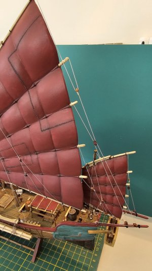

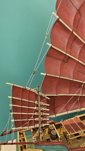

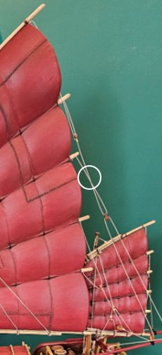

Well I just noted an annoying error in the rigging! I have a twisted line in the Main sail sheets...
How to replace the line...aaarrgghhh....it is interlocked with others and it would mean removing about 4 lines and two blocks. And the main sail is quite heavy for the mast so it is a delicate job, and I would need to be very careful. I will investigsate trying to untie the end connected to the batten. Some debonder *might* help to get it done, and perhaps leave me with enough line to re-tie it. Wish me luck...

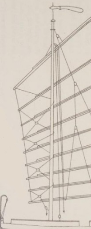

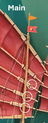

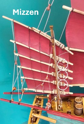

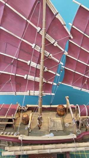

If I am going to do that then I might as well also fix the luff-hauling parrels on the main sail. They were attached before I added the sail to the mast. They should go about half way between the luff of the sail and the mast. Here is the mizzen sail as an example, and a diagram from Worcester.
Luff-hauling blocks marked. All in correct position.
Well I also placed them in the "correct" psition on the main sail before I added the mast. The problem is that the kit wants the mast in a crazy position - bottom batten is on a drooping angle, and its below the deck and way over the side. So I repositioned the mast, and how it is attached to the sail, to get it to sit much better. Now the luff-hauling blocks are too close to the mast and get closer as we go further down the mast...
I might be able to fix this relatively easily.
If I am going to fix the twisted sheet (and I am because it is REALLY annoying!) then I might as well try to fix this also.
So...the junk is *not* finished yet...

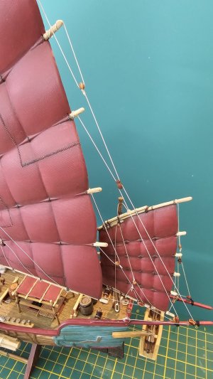

Well I was lucky!
The sheet was tied to a batten with a couple of extra winds of the line around the batten - so it was easily unwound, and thus when removed there was enough to re-tie it! So the sheet was easy.
Similarly I undid the spiral line on the luff-hauling parrels and moved the blocks away from the main mast by looping the line around the batten, thus shortening the line. Also, an easy fix!
And now...I declare it FINISHED ... except for adding a figure when they arrive :)
