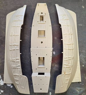

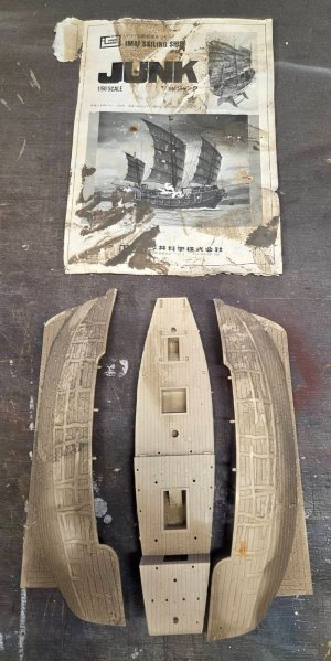

John, could I bother you for a copy of the instructions? Mine are badly damaged by Katrina flood waters and are in Chinese, would yours be in English?, I've washed off all the dried mud and starting the pre-prep process.
Sure. I've sent a DM. Send me your email.
My instructions are in Japanese but I had AI translate them. I then tried to recompile my own set using the diagrams and the English instructions. I can send you that as well.
