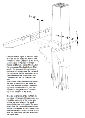

Well this has me puzzled.

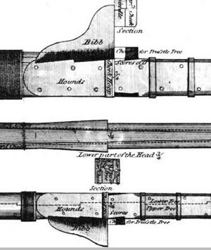

I cannot figure out Steel's description.
Does anyone have a better description of the shape of a Chock for the lower mast?
Regards
Allan.

This is not helped by the drawing accompanying Steele's description being a little confusing.
Hi guys. I know it is being fussy. Lee's description is accurate but there was clearly some more detail in it. Steel shows different chocks depending upon the size of the vessel. One clearly says scores next to the chock which means rebates or chamfers. Anyway I will go with what I have drawn until something comes to light. Thanks for replies. Regards Allan
