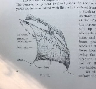

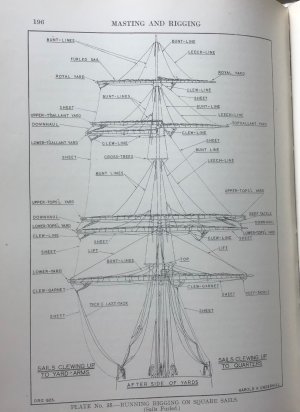

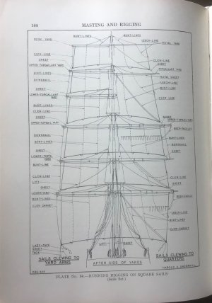

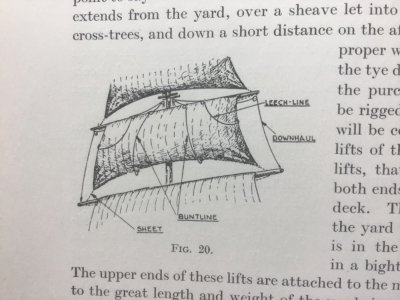

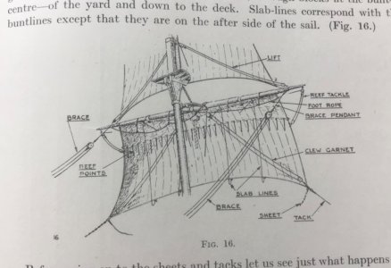

Steve,
Just to give some examples of drawings in Masting and rigging of the ocean carriers.
Book is by Harold Underhill.
A very well detailed book.
Steve,
