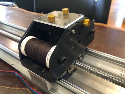

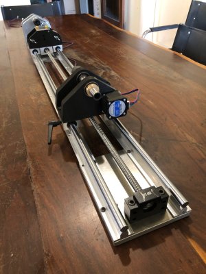

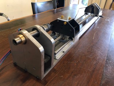

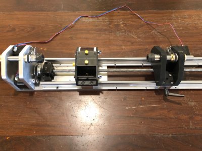

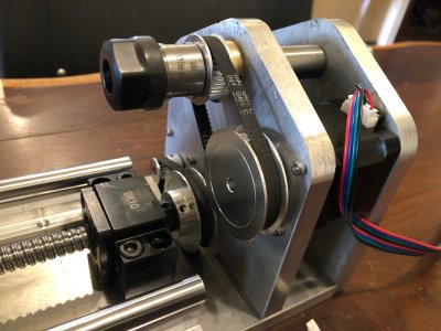

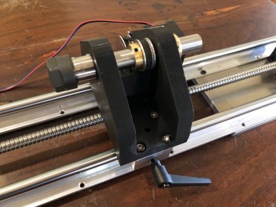

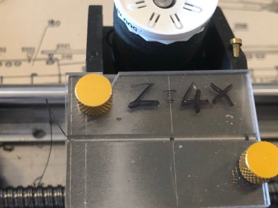

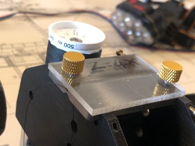

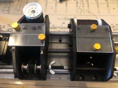

The mechanical parts of the machine are shown in the following photos. 800mm between centres. Nema 17 steppers. Electronics-Control box not shown here. See CNC Mini Mill thread.
When I have tested it, and made any adjustments I will show a video.IMG_5457.JPGIMG_5457.JPGIMG_5453.JPGheadstock.JPGbobbin holder.JPGserver2.JPGtailstock.JPG

The advantage of CNC is that very fine adjustment of the pitch of the serving thread is possible. Using a ball screw means that there will be very little backlash. And also the speed of the overall process can be finely adjusted.
The tension of the serving thread is less precise, but adjustable. There will be a learning curve.
Lateral movement of the rope might be a problem, but the groove can easily be remade narrower, if necessary, by reprinting it. (ps or making it in metal.)

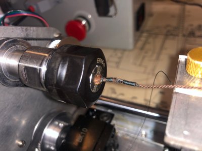

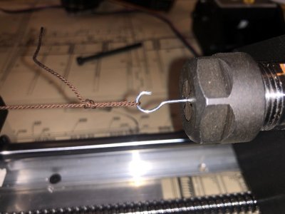

First serving runs today exceeded my expectations. The machine worked close to perfectly, and after trying variations of the settings, and finding that I could push the machine speed to the limits of the Nema 17 motors, I did a 600mm length of serving 1mm diameter home made rope in about 2 minutes.
I can see a couple of areas to improve. The spool carrier groove needs to be smoother, and I will make a replacement top plate from metal, and send time polishing it. And I will design and make a V shaped extension carrier top plate to allow close access to the top plate thread hole for seizing close to deadeyes.

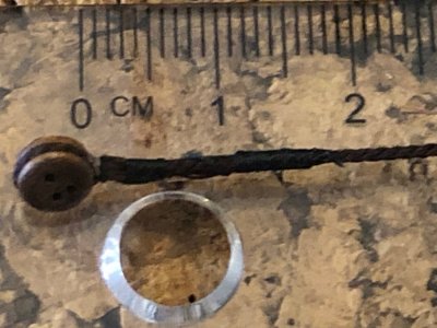

The first photo is 2mm x600mm rope, served with a several starts at different settings. The second photo is 0.9mm white rope served with brown Guttermann thread, pictured vastly magnified. I did take some videos, but the video quality is ordinary, and I will try to improve the video setup before publishing.
BTW, these ropes were rejects, used for first serving attempts because I was just experimenting and expected them to be thrown out. But with the serving, the poor rope quality is not so visible, hey?
