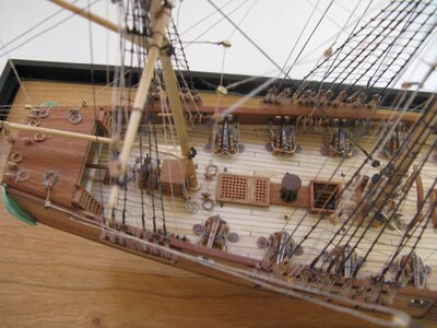

Here's my technique. Smear a thin film of white glue on a piece of 3x5 card. Make the coil in the glue (it will hold the line as you form the coil). Let the glue dry than carfully cut around the edges of the coil so none of the card shows. The glue the card with coil to the deck. Works for me. An example is in the attached photo.is there a way to coil small rope my attempt are not very good all idea are most welcome
