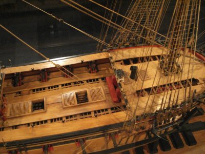

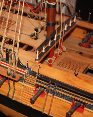

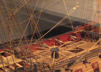

I looked at contracts regarding paint. None of them state a color, but, cost was always a factor and red and yellow ochre were cheap by comparison, thus the most commonly seen. I am not a fan of painting carriages or other items inboard, but go to Swiss pear or bloodwood for some items that may have been painted red. From the contract for HMS Elephant (74) 1786:
To treble paint the Ship without Board with good Oil Colours, and in like Manner the Great Cabin, Steerage, and all the Cabins, Rails, Stantions, Ladders, Gratings, Gangways, Bulkheads, Capstands, Upper deck beams, and Knees, and all the Work both within and without board for finishing and compleating the Hull of said Ship, shall be done in a Workmanlike Manner, equal in all respects to those of His Majesty’s Ships of the like Quality in the King’s Yards.
L
ooking at contemporary models, they were either unpainted or red, but this does not mean other colors were not used as well.
