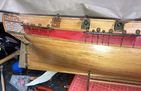

On a similar theme, but French! The way I did my hull 30 years ago no longer pleases me, and I want to redo it a bit more realistically. Any suggestions what the French were doing in the early/mid 1800s? Contemporary pictures don't show below the waterline, and the positioning of the gun-ports makes one wonder if the model is of the same ship! I think it's too late to do the upper hull, but waterline downwards should be possible. Did they use cuivre or 'truc blanc'?

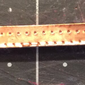

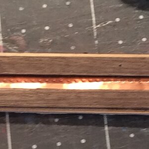

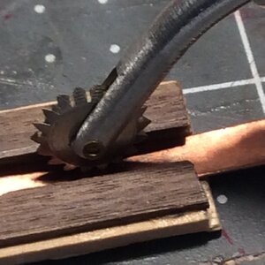

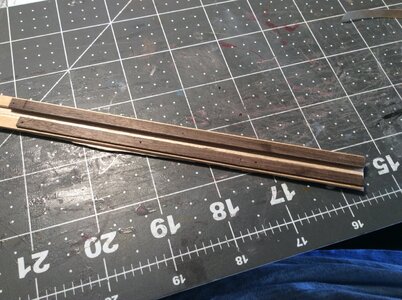

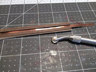

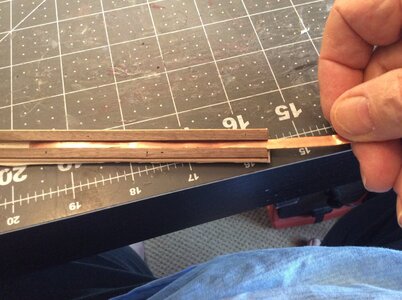

I took two pieces of hull planks and spaced them apart the width of the copper tape then glued two more hull planks on top of the first two but overlapping slightly into the space for the tape. Then run a length of tape into the tape space. Use a pointed, not sharp, stylus to scratch lightly across the tape to the length of each tile of copper you are creating. The next thing is to use the stylus to mark the simulated bolts on each tile.
I put 4 on each side with one at each end in the middle.
Hope this helps. I will check to see if I have the jig and post a photo.
