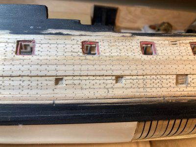

After I finished my Santa Maria I went back to my Confederacy. I had finished the hull before going the Santa Maria. I decided to paint hull below the Wales because I didn't do a good enough job planking the hull to leave it unfinished. I left the hull above the Wales natural. I still need to add the rudder and make for adjustments to the stern castle. I planked the deck and have left it natural. I want to add simulated treenails for detail. I added simulated treenails to the hull but I think the holes I drilled are too large so it's not what I hope it would be.

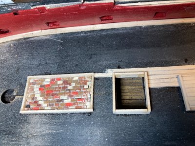

I added simulated bricks for the oven/rotisserie to sit on. When added very little of the "bricks" show but I think it looks good.
I've installed the hatch coamings, the hatches and some ladders. More detail to come for the hatches (rings).
